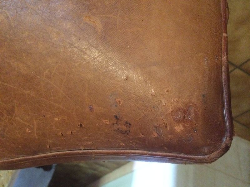

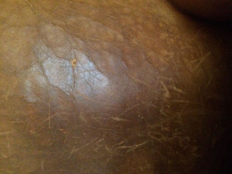

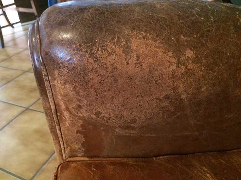

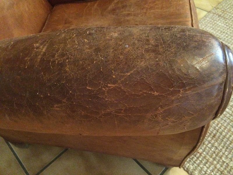

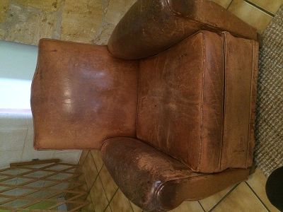

I got a club chair whose leather was never maintained. I think it's made of dyed sheepskin.
Leather therefore has different forms of stigmas:
- cracked leather (lack of oil or cream feeding)
- grease' places (armrests)
-small scratches (cat and small blows on the leather)
After looking at your different products I thought I would buy:
In 1) your Club Chair Remover Cleaner Spray then, in 2) do I need to apply a repair product? type your Club Chair Leather Regenerator or Club Chair Leather Healer? because I find that the scratches or marks do not seem very deep, OR can it be sufficient to apply Beef Foot Oil that will renew the leather and blur the marks?

First step the cleaning with the detachant cleaner, remove the dirt with a microfiber cloth, be careful you have fragile areas or the flower of the leather is missing. Let dry and sand lightly to smooth the leather. Your leather is very porous and requires the application of the regenerator before spreading the oil''foot of beef''. We offer you the regenerator, grease and wait 48 hours before repairing the leather flower and scratches with the healing agent. Finally we recommend the tinted wax to remove all marks and protect the leather from friction due to use.
