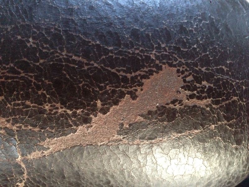

I dreamed of having a club chair but not the means to buy one; my partner came back one day with a chair and said to me: I'm sorry, I couldn't do better......... so here I am with a chair that I find beautiful but....... to restore so I turn to you to know what and how to do so that he can be part of the family?
in advance thank you
It is quite possible to restore your club chair, the damage does not seem so serious.
I recommend this renovation kit for club chairs.
-Start by sanding everywhere with fine sandpaper grain 240, in order to remove the parts that are crumbling.
-Use the repair paste to fill in the material gaps by applying it with a spatula, sand down the excess.
-Recolour the colour of your choice.
-To recover a shaded and aged effect, use our club chair dye sprays and then apply protective wax for a very pleasant "candle" feel.
-Grease 2/3 weeks after renovation with oxfoot oil.
