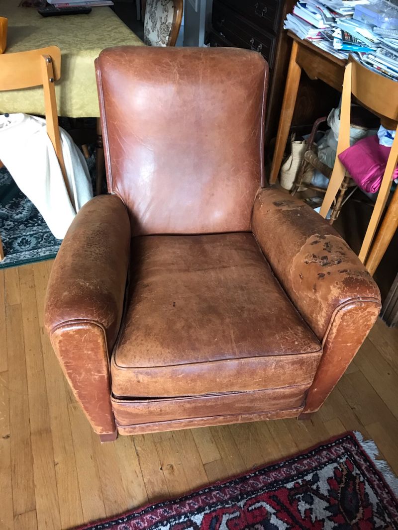

Do you think your products can perform a miracle on an armrest in very poor condition?

    Your club chair is indeed very worn out but it is possible to renovate it.
    -Use the old leather regenerator for your armrest, this to reform a layer imitating the grain of the leather.
    -Fill in deep holes and/or scratches with the repair paste.
    -Sand all over with 240 grit with the weight of your hand, without forcing, and degrease with acetone.
    -Recolour the colour of your choice.
    -Varnish, to protect the leather and colour against friction.
    -Grease with oxfoot oil 3 weeks after renovation.
    All products are included in a club chair renovation kit, with detailed instructions.
