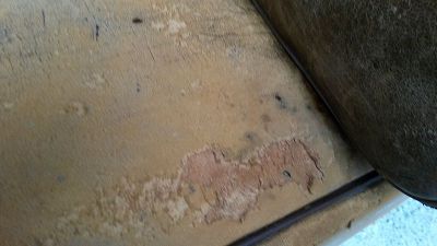

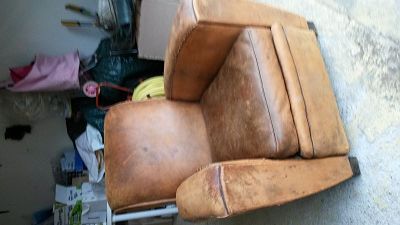

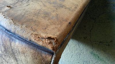

I have a club chair to renovate. The color is passed through and there are rough areas (armrests) and 2 holes.
Can you help me? Thank you. Thank you.
The renovation is perfectly feasible. First you have to fill the holes with the repair paste, we will offer you the necessary leather parts. Then you need the regenerator and the'Beef Foot' oil to restore the leather's resistance. These operations are to be done before the recolouring which must be done in 2 steps. First of all, apply the pigment recolouring agent to all repaired areas and rough surfaces after sanding. Then tawny dyeing and patina wax.
