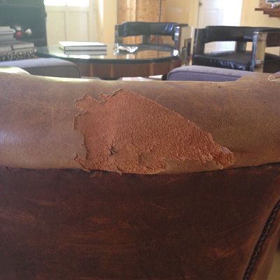

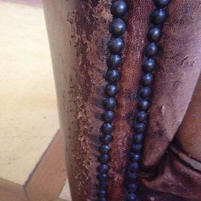

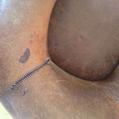

I just bought two club chairs. One is quite damaged, it is stained, clawed and a leather morecau is ripped off superficially. Could you be so kind as to help me by advising me on what I can do to improve his condition?
I enclose 3 photos.
Thank you very much,
Only the repair paste is used to repair the flower of the leather. The repair on the 2 pictures is the same, you apply the paste ( a kind of putty) that we can tint you fawn, after each coat you have to sand to obtain a smooth surface, you will block the degradation, the leather will not move anymore. Finish by applying a tinted wax to the entire chair to even out the colour. Your repair is simple to do, we will advise you.
