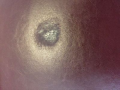

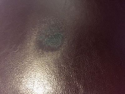

A "hole" has appeared on the back of the sofa, about where the head rests. It's as if the leather had disappeared.
We can distinguish a kind of dark matter that is sticky.
How can we fix this?

Start by cleaning with sebum cleaner, your leather is burned by seborrhoea. It will be necessary to make a repair with the repairing paste, recolour and varnish.
