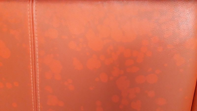

I am interested in your products to renovate a stained sofa after storage in a humid place.
Is this possible and what are the products or kits to order?
The desired color is bobois rock atlas chocolate, do you think it is suitable

    yes, this is perfectly possible. When a stain is impossible to remove, it is necessary to repaint the surface. Generally we do not paint only the tasks but the whole sofa if we want a perfectly satisfactory and homogeneous result.
    In order to better guide you on the products and quantities, could you please provide us with the information below:
    - material to be treated?
    - surface of the sofa (number of seats)?
    - Do you have any repairs to make (cracks, cracks, small holes that have not passed through the material)?
    - current color?
    - expected color (same as current color or change)

    it is a fully repainted sofa, it is made of leather and the current colour is terracota
    there are 4 seats and a driver.
    I would like to change the colour of the bobois rock color chart atlas chocolate, do you think it is suitable

    Thank you for your feedback. You didn't specify if you had any repairs to make. It doesn't matter though because I advise you to opt for the renovation kit leather sofa 4/5 places here.
    This discounted kit contains all the products required for your sofa. Concerning the colour, choose the one that suits you best (chocolate is very good). In any case, once your order has been validated, we will send you a numbered paper colour chart so that you can judge the colour and confirm it to us.
