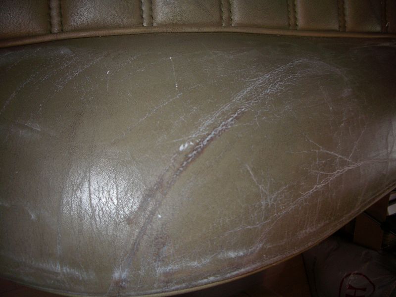

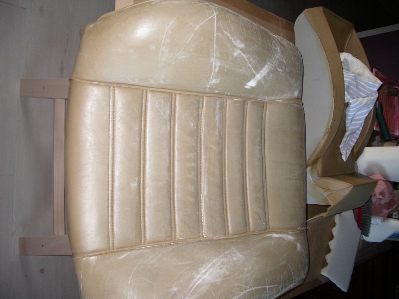

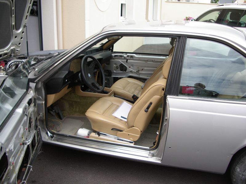

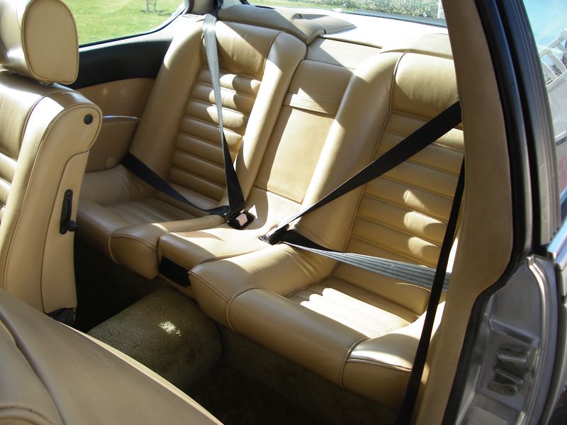

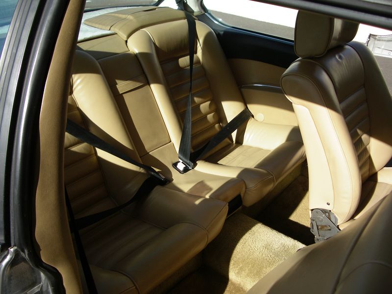

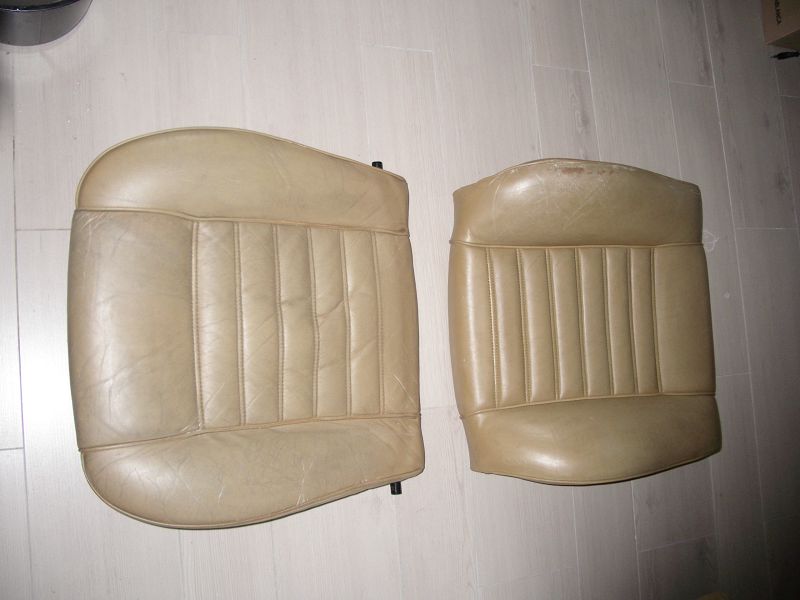

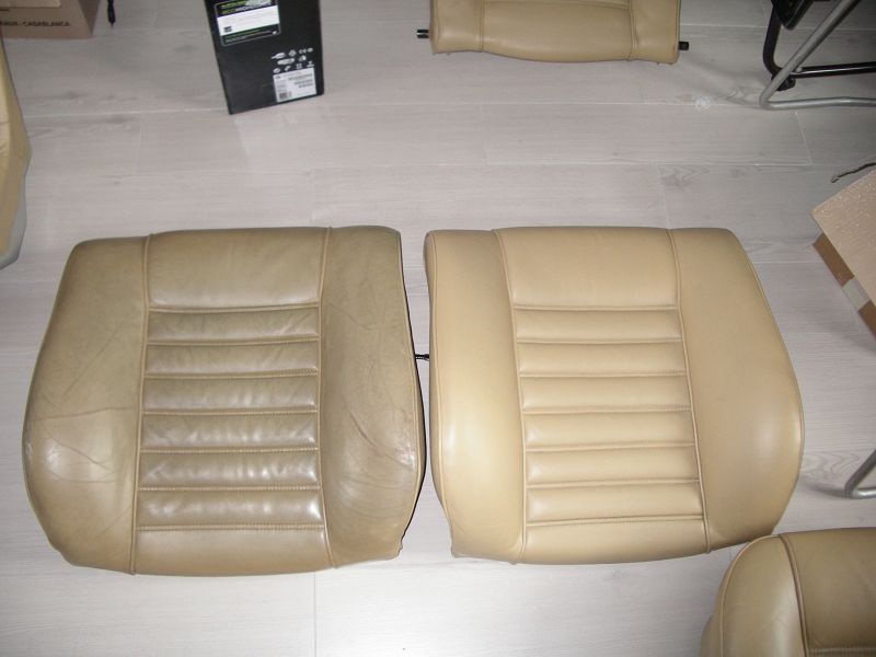

Hello, Last winter, I took the opportunity of the winter installation to completely redo my leather interior and re-color some skaî and plastics with SOFOLK products. photos and videos are available to materialize the result. big work because complete disassembly of the seats, you have to take your time and everything is fine. hello to mr Sablonnière.jef

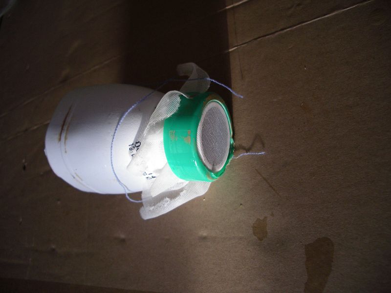

    After this repair, I would like to share my experience: it is necessary to remove the original varnish (sanding and solvent), the areas I have neglected a little on this point, the colour does not hold well, especially, sieve the product well before application, because material that has dried (on the neck of the bottle) is on the surface of the seat and creates a slight asperity. I made a filter with a plastic milk bottle, I pierced the cap and put a cloth kind sticky woman.See pictures

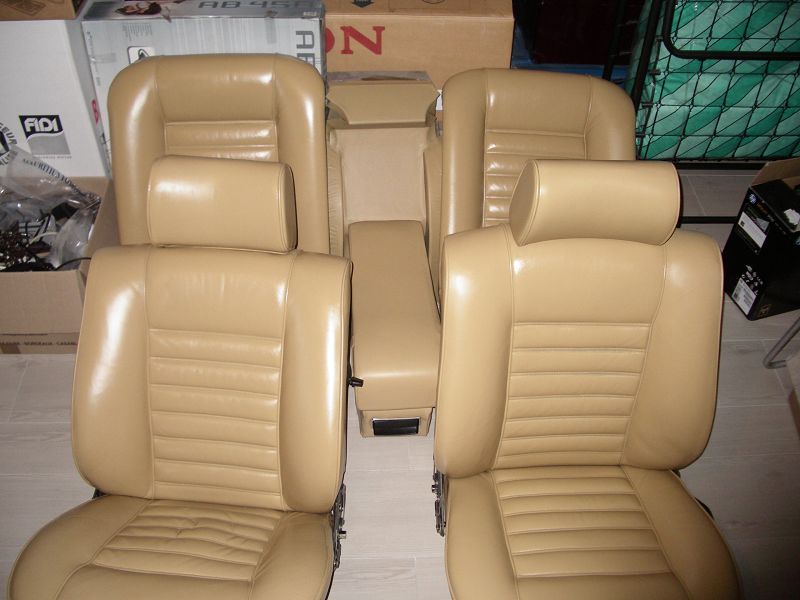

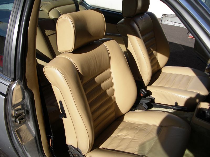

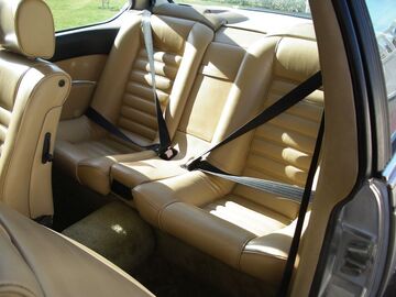

    and the photos of the finished interior:

    I would have liked to know the colour of the leather used for this refurbishment, before I also signed up for my 323i from 85.
    Sincerely.
  5. Reply
    Hello, the shade was made on request, on leather sample by SOFOLK.cordially
