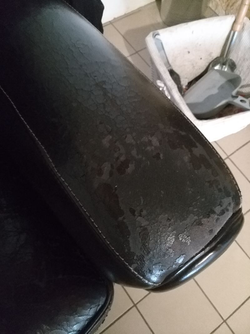

I got a chair to repair. I can't tell if it's leather or imitation leather. Can you direct me through the photos? And so, tell me the right products to use

    On the picture sent it is difficult to pronounce itself it would be necessary for us a close-up of a deteriorated place. If you have the opportunity to see the other side of the material, imitation is a fabric woven like an oilcloth.

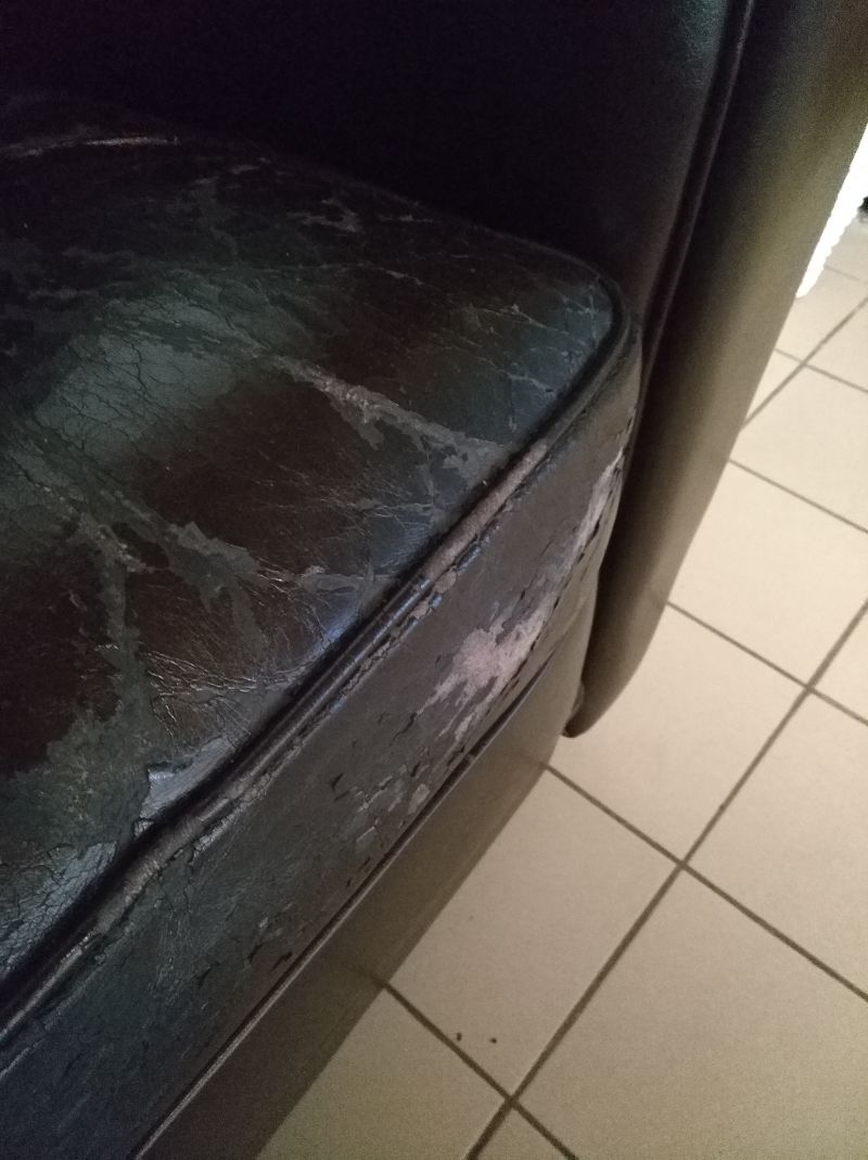

    I can't see the other side of the material, that's why I doubt it. I attach another photo

    Leather rarely degrades in this way this happens on burned leather, this degradation looks more like an induction layer problem that crumbles.
    We can provide you with a compatible repairer and recolourer on both materials, which will be the best solution.
