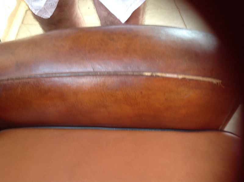

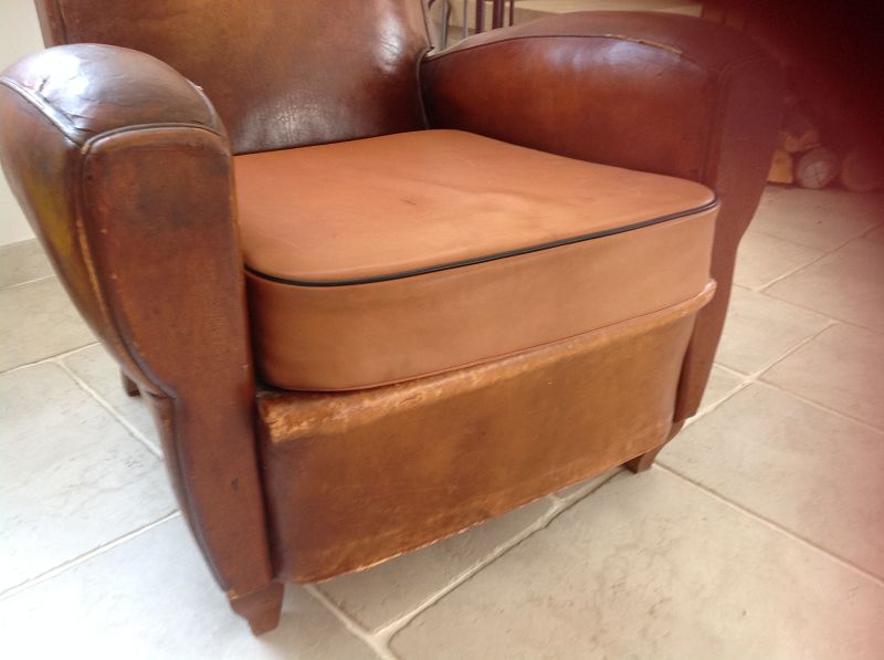

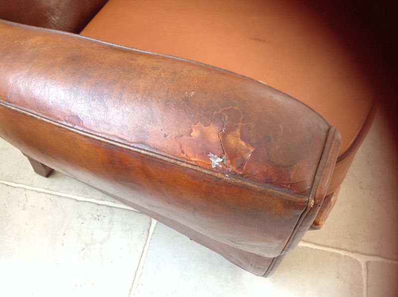

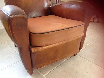

I bought a leather club chair, but it has a big problem with the armrest.
the leather is very damaged and cracked. Is it possible to renew this kind of problem with the repair paste and what are the other steps to clean, degrease and re-dye the chair, knowing that the seat has been redone but it is much lighter than the rest of the chair. It is also used at the level of the small beads, a kind of rope that completely surrounds the chair (I hope to be quite clear, I put some pictures to support you)
thank you for your feedback

    No problem to renovate your club chair properly, you can catch up on the colour of the cushion and piping.

    Thank you for your answer.
    What product do I need to use to carry out the renovation?
    it is indeed the piping that is damaged, it is not just colourless, it is used in places. what should we do?
    As far as the tear on the armrest is concerned, the leather must have already been restored, it lifts off in places.
    will the paste be enough or do we have to add something else?

    For the piping it is necessary to glue a very fine leather that we will provide you. For the repair very badly done on the armrest it is necessary to undo to slip a piece of leather that you will stick with the paste. You need paste, wax dye or tinted wax and foot of ox oil to rehydrate the leather.

    As far as the armrest is concerned, I have to cut out everything that is loose, if I understood correctly.
    do you also provide the leather part?
    can you tell me how much the renovation pack is and how long it will take to get it delivered?
