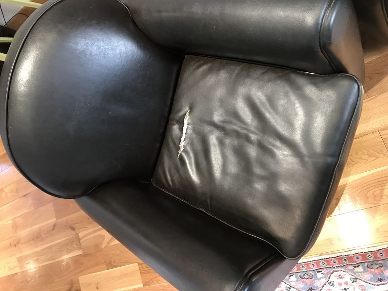

Hello I have had club chairs for 13 years, and there is one for which the leather of the seat is now torn on about 20 cm, due to wear (so cut very sharply).
Do you think it's repairable?

    your leather tear on your club chair is repairable.
    For this you will need the following products:
    - a piece of leather large enough to be inserted between the foam and the leather.
    It should be larger and at least 5 to 10 cm wider. The larger the part, the stronger the repair will be.
    Order your part here and indicate in the comments the exact size of the part.
    - 2 or 3 tubes of leather repair paste (depending on the size of the leather piece). The paste will be used to make the lamination (details here)
    - 250ml of black paint for the leather (you will have to recolour all your sofa to obtain an impeccable and perfectly homogeneous finish.
    - 125ml of satin-finish leather varnish
    - 125ml of nourishing leather oil
    Here is the link to the instructions for use (once the tear has been repaired)
