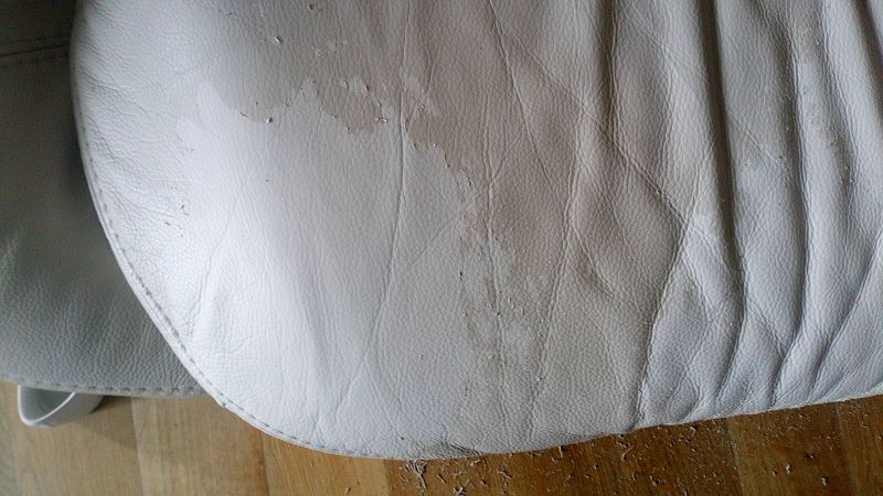

White leather sofa that peels straight away
3 answers
Photo follows
This leather has been badly recoloured, you have to undo everything, sand the leather with fine sandpaper, recolour and varnish.

Hello ,
Thank you for your answer.
The sofa has never been re-colored before. I'll sand it down to start with, then I'll come back to you.
Impossible we can see well another color underneath it is not the raw leather, you may not have recolored it but it has been recolored. This layer must be removed with acetone and then sanded to prepare for a new colouring.
