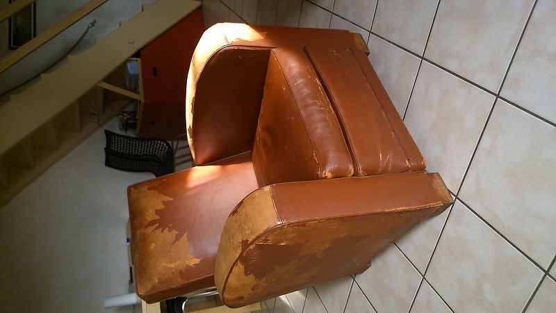

Some time ago I got a club chair (Normandy model I think) that must be a few years old. (maybe 60's)
The leather, certainly due to lack of moisture, was very dry, brittle and flaky in places.
I tried to feed him but that wasn't enough.
So I dropped it off at a upholsterer who was supposed to renovate the leather and give me a new patina.
Serious mistake! a bad craftsman... (I can possibly give you these coordinates)
Basically he repainted the patina of the time with a kind of paint shiny plastic appearance without any shade.... (I even saw the low-pressure paint gun in his workshop) Goodbye my patina from the 1950s.
In short, not being able to support this new plastic aspect anymore, I decided to do a new patina and while looking for information I came across your site.

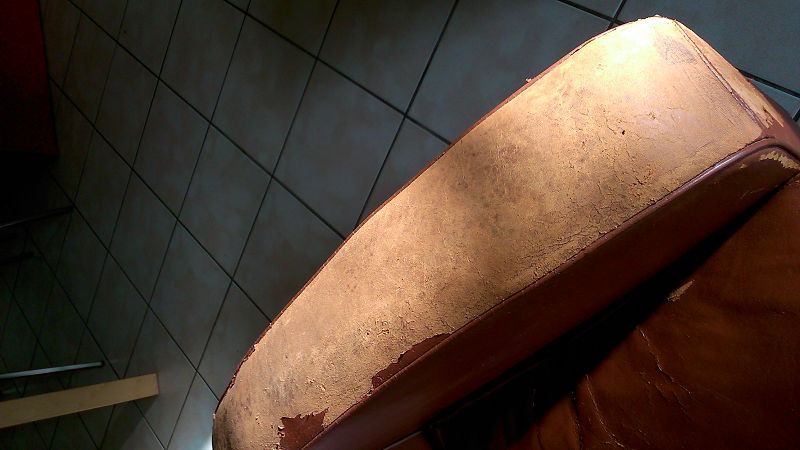

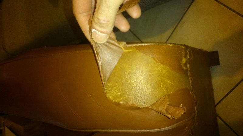

Looking closer I notice that the plastic layer does not hold and peels, unfortunately not from everywhere.
So I decided to remove it to get a raw leather and re-skate it.
Several things.
- The plastic layer holds seriously in place in places. I don't dare use a chemical stripper. Do you have an adequate product?
- Removing the layer tears off the old patina and the leather is really raw and dry. Is there a need for a cleaning and degreasing product before patina? And what is needed to seriously hydrate it?
- the leather is a little cracked, flaky and even has a few small holes in places. Can I use a filler if I want a patina (and unpainted) look afterwards? I also think that the resin to glue back the scales and addicts is necessary.

It is reparable, the first thing to do is to strip the chair to find the flower of the leather, we have a product for that, it is the Degreaser Stripper, then you will grease the leather with the Oil Beef Foot and depending on the condition of the leather and what you want to obtain aesthetically, we will advise you. First remove this film. We will dose the stripping agents harder, you will need to use solvent-resistant gloves and a good roll of sopalin. Then on the cuffs, backrest and seat cushion, a good dose of oil.
