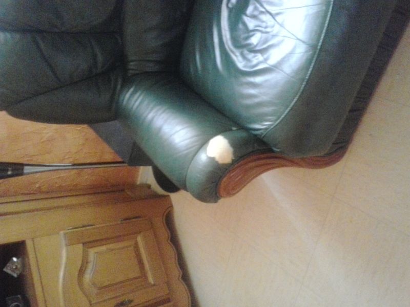

What products should I use to repair a hole in the dark green leather sofa, how should I proceed?
Thank you for your answer.
Is all the white we see is foam or is there still leather?
It's foam.
You must slide a piece of leather into the hole, a little larger by at least 2 cm across the width and flush with the seams. Once this piece of leather has slipped, coat it completely with Repair Paste. This paste will glue the piece without retracting it and give you time to place it properly. When the piece is glued, apply thin layers of paste, sanding after each application until the leather level of the armrest is restored, then apply the green Pigment Colouring Recolourant. It seems to us that the colour is not plain, is it shade? The leather piece will be offered to you, please specify it in the comments of the order.
Thank you for everything. That's very kind of you!
If I put my piece of leather end to end and it needs 2 cm wide I will have a piece left I will cut it so that the ends meet because I would have extra leather.
You must size your leather piece as follows: the 2 sides that will be flush with the seams (width; distance between the 2 seams). The other 2 sides must be 2 cm larger on each side than the hole . All you have to do is slide the piece of leather between the foam and the flesh side of the leather.
Thank you very much for your answer.
