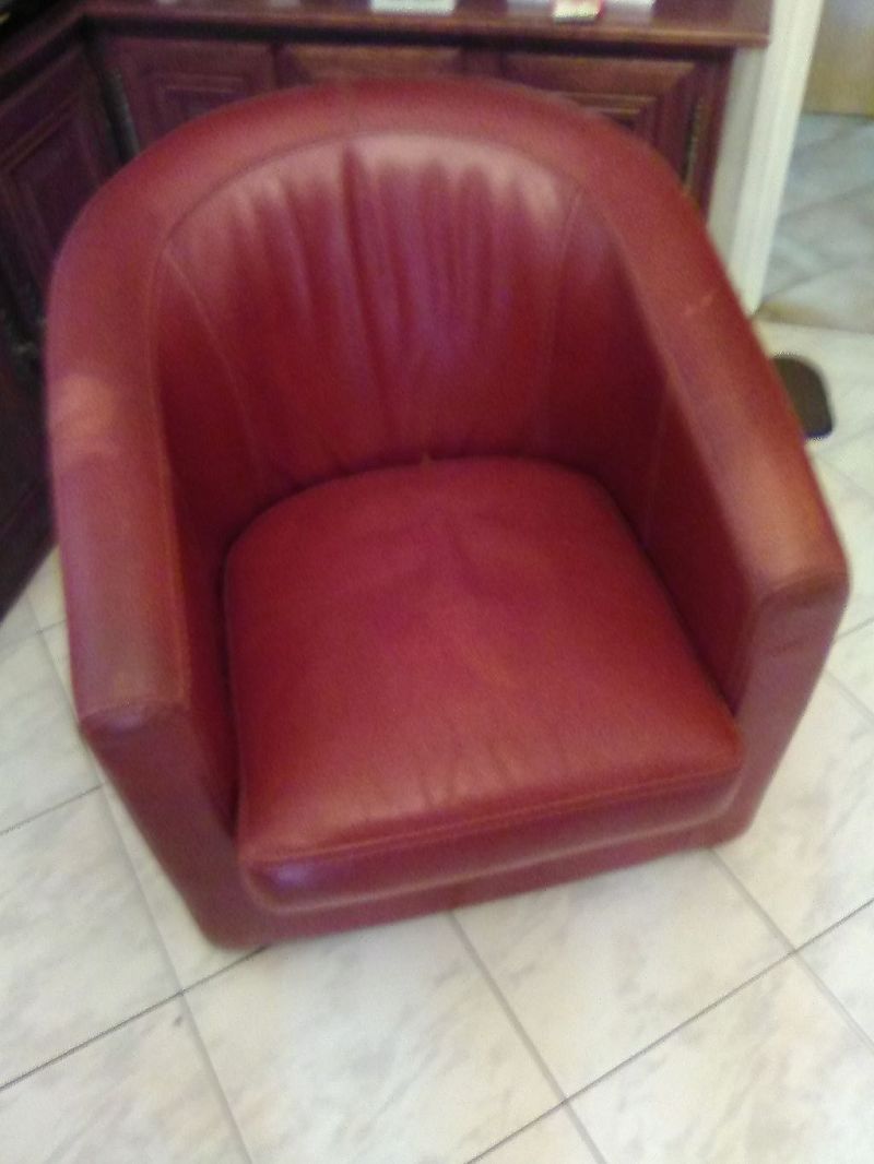

Good morning, gentlemen.
In 2004 we bought a buffalo leather lounge set from ATLAS. Stores that have closed as many councils as possible....
Attached is a photo of a lounge element and its invoice reference (bria cab brigitte 465 maestro 05004/4).
Unfortunately, the red disappears especially on the armrests and the head.
Do you think you have a solution to restore its color?
Thank you in advance for your answer.
When you see your picture, you will have to re-colour your chair. A good renovation to obtain an impeccably homogeneous result is to recolour the whole chair and not only the discoloured parts.
For this, you will need 250ml of leather paint to be made in your colour (from a colour chart or a small leather sample of 1cm mini).
You will also need 125ml of silky satin (or shiny) leather varnish to protect your leather from repeated rubbing.
Finally, you will need to rehydrate your leather 30 days after your renovation with 125ml of leather moisturizing oil.
A complete manual will be delivered to you at the same time as your products.
