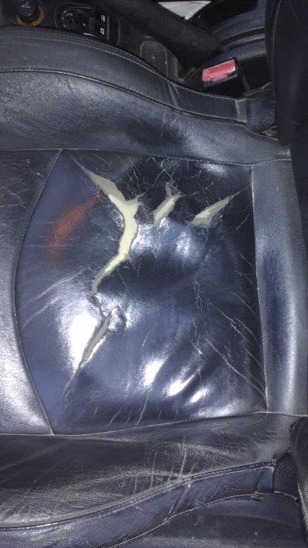

Can you tell me if the tear in the leather seat of my Peugeot 206 can be repaired with your kit? Thank you in advance for your answer.

    Yes, your Peugeot 206 seat is repairable, however there is some work to be done!
    You will need a leather car seat renovation kit, a large piece of fine leather, one or two Replenishment tubes (in addition to the one provided in the kit)
    (Call us directly so that we can provide you with a piece of leather at the right size, online it is 20x20cm max)
    -Start by removing the dry and irregular edges of your tear with scissors.
    -Place the large piece of leather under the tear, protruding a few centimetres.
    -stick it on the back of the leather of your seat, using Replenishment or neoprene.
    -Fill the wounds with Repair and then sand until a smooth surface is obtained again.
    re-colour, standard colour, manufacturer, or customised.
    -Varnish to protect the colour and obtain a satin finish.
    -Feed with the oxfoot oil.
    For an easy application, I recommend our accessory kit.
    In case of doubt, our customer service is at your disposal to answer all your questions and assist you in the renovation of your 206.
