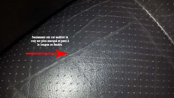

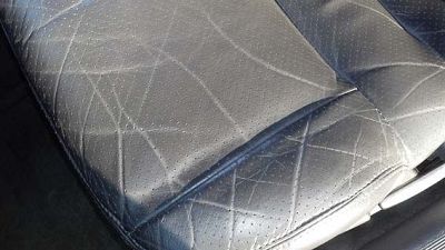

I need another advice
For my other car (picture above), the driver's seat is not yet cracked. Just a mark that could split (photo 1). In your opinion, would the colourless renovation kit without coloration with the healing stick be enough to stop the degradation and renew the seats or, in view of the picture of my first message, it would be better to use the complete renovation kit for all the seats to plug the imperfections that have formed like the one I ordered for my other car to remove the marks. The driver's seat is not damaged (photo2)
Thank you for your advice
Photos
photo 2
In view of the photos, the leather healing is sufficient, it will prevent the crack from moving away as would the paste but without being forced to recolour. A good lubrication, the blocking of fragile areas with the healing agent and a good layer of varnish with maybe a cleaning if the leather is dirty, these 4 operations are sufficient. The colourless kit contains the 4 products to renovate this vehicle.
Sofolk
Thank you, I'll order the kit.
