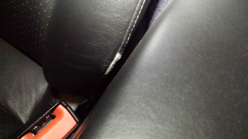

Good morning, everyone,
I have a tear on a leather/leatherette seat (I think the seat is made of leather and the side strips are made of leatherette).
See the picture.
Is it catchable?
Thank you in advance for your support,
kind regards
It is reparable, you have to slide, between the foam and the leather, a piece of leather 2 cm wide and one centimetre longer at the top and bottom than the length of the tear. Glue the leatherette part with neoprene and the leather part with the repair paste, then fill the crack with the paste and recolour this part with the pigment recolouring agent.
