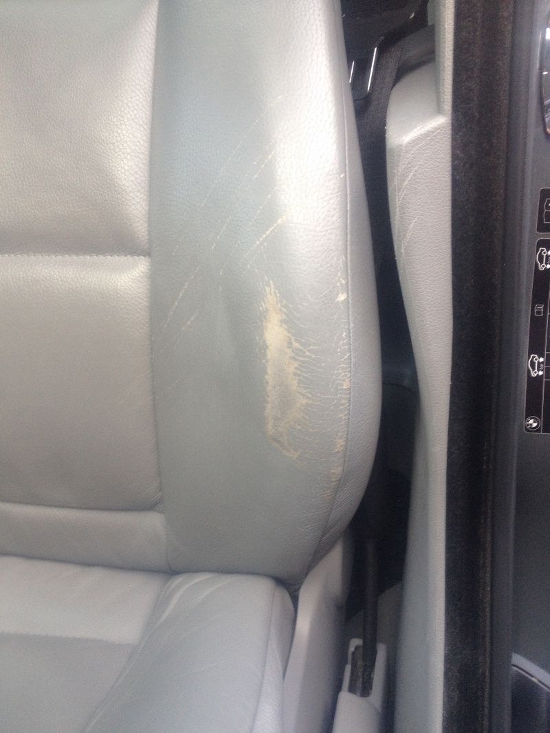

Hello I bought you a leather cleaner and a grau60 bmw shade for.I attached a picture of my seat before treatment.I cleaned it with Marseille soap and then with the leather cleaner you provided me.I applied a coat of the dye.But there is a minimal difference in colour and on the shaved part as well as the claws the staining is clearly visible, what should I do knowing that the leather is not smooth, will a repair paste show up? do I have to do the complete siege in staining? thank you in advance? Jeremy .
Apply several coats on the worn areas and when the leather is dry, sand a little to smooth and finish with a final coat. One layer is far from enough.
Hello, thank you for your answer but I still have two more questions: Do I have to redo the lumbar vertebra or the complete seat to make no difference? With what to apply the colouring? Foam roll or piece of foam by making small circles? Thank you in advance.
It is better to redo the entire seat. You can apply the reclorant in both ways listed but the most effective is the foam roller.
Thank you, I will post the result when I finish it.
