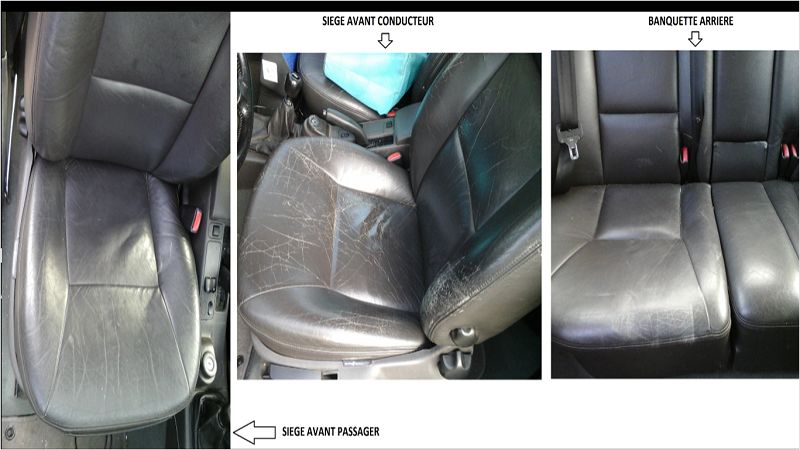

I want to repair the 2 damaged front seats of my vehicle (SAAB 9-3) in black and restore the brightness to all seats and rear bench (included headrests).
I could send you by email pictures to show you the state of repairs (these are at first sight wear cracks, no holes) to be made and have your advice on the products to buy to cover all my needs and the methodology as well as the time for the realization of the whole, including drying.

Your renovation is very commonplace, it is simple to carry out. Light sanding to break the original varnish, acetone cleaning, crack repair with paste, foam roller re-colouring and sponge varnish application. During this operation, half a day with the drying times, the complete kit for front seats and rear bench will suffice, all for 99.90 âA. Detailed instructions for use, book with kit.
