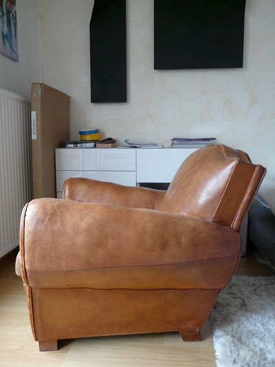

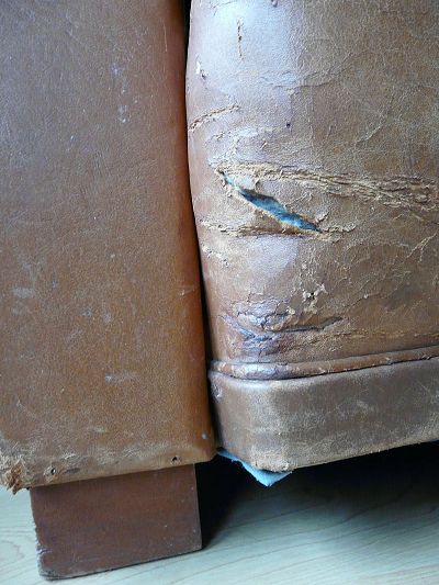

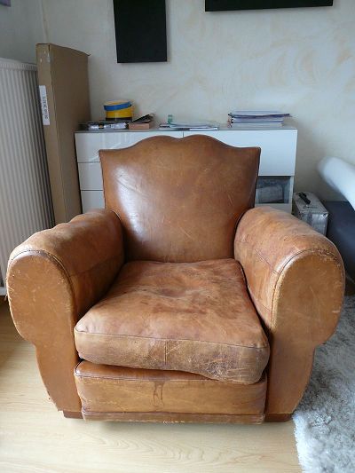

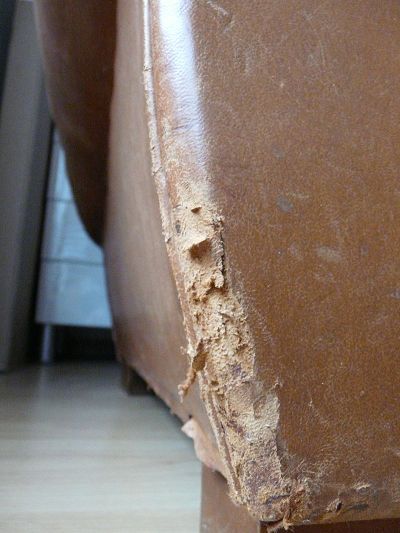

I have just bought a club chair and I discover that it is in pretty bad condition.
He suffers from tearing (cat claw type) but also from clear tearing. I'll post you some pictures as soon as I can.
Questions :
Can I repair scratches AND tears with your "old leather renovation kit for club chairs"?
The current colour and the patina of time please me enormously, I am afraid to obtain a "painting" effect with the pigment dye. What do you think about that?
Can I apply a tinted wax to my repairs?
Could I get a "real" patina with the kit mentioned above?
Thank you in advance for your help
You can keep the patina ( in better) and the color but you will have to use pigment recolorant on the repaired areas. We will provide you with a lighter recolouring and then by passing the tinted wax over the whole chair you will equalize the colour, there will be a small difference between the repaired parts and the rest of the chair but it will be minimal and it will be ten times better than recolouring everywhere. You must first regenerate the leather to solidify it and grease it well with oil before repairs are carried out... The old leather renovation kit is not entirely adapted to your case, it is necessary to replace the stripper cleaner by the detachant cleaner and replace the 250 ml of pigment re-cololant by 125 ml of re-colourant and 150 gr of tinted wax, it will be necessary to specify it in the comments of the order and a piece of leather for the repair of the hanging front.
