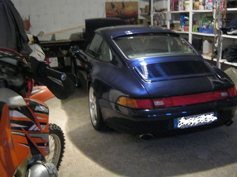

Hello everyone
First of all I wanted to say that these are great products and that they are easy to apply.
You just have to follow the order of the different steps and respect the drying
time. I unfortunately didn't take any pictures before, but the conductive seat was cracked and it had a 5 cm tear on the backrest. When driving, the knob, and the center console, Is had traces of nails from the former owner.
So I sanded them, I put the repair paste, sanded, stripped, repigmented, repigmented, knotted with oil
I also took advantage of it to do the maintenance of the rest of the interior
Thanks again to Sofolk and especially to Mrs. Vadeleau Laurence (it's exactly the same shade)
