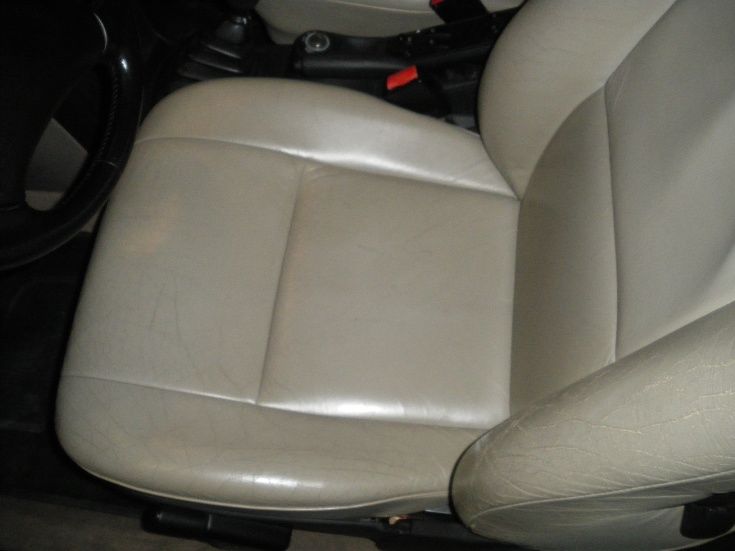

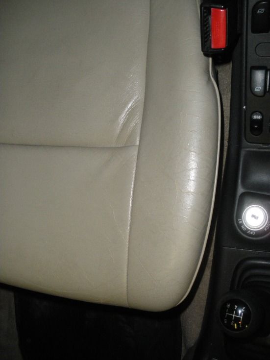

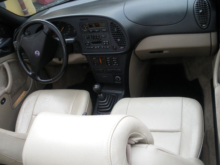

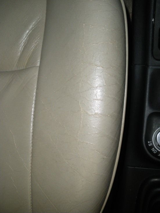

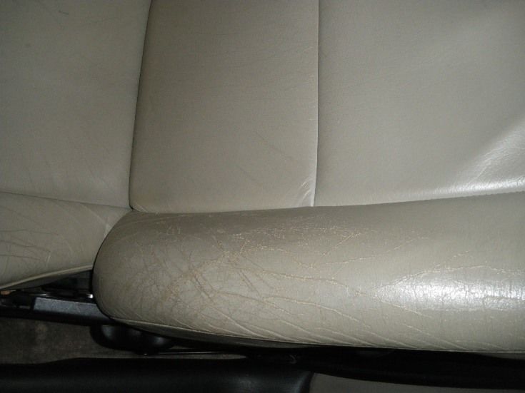

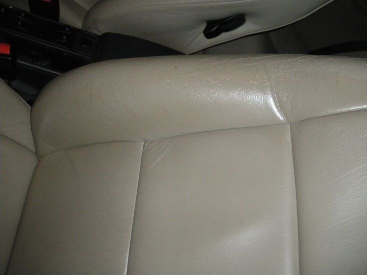

Good evening,

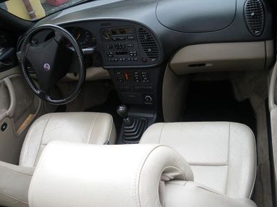

I own a 1996 Saab Cabriolet, cream leather, and I have a sample that I can send you.

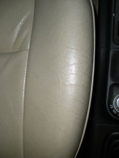

My leather is colourless but above all cracked, but no holes to fill.
JI'm thinking of leaving on your complete Kit. But I would like to know your opinion (with photos sent) on the quantities of products to use and if it would not be necessary to have a supplement to be sure to have everything on hand at once.
Sincerely.
However, we advise you to sand the leather well where the cracks appear and after wiping the dust, to apply a first coat of recolouring agent and only after examination to apply the paste. By practicing in this way you will limit the repair, you can of course send us a sample of the leather that will be used to make the colour. Your colour is clear, it is necessary to provide 250 ml of additional recolourant for the rest of the products those contained in the site will be sufficient.
