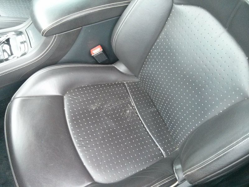

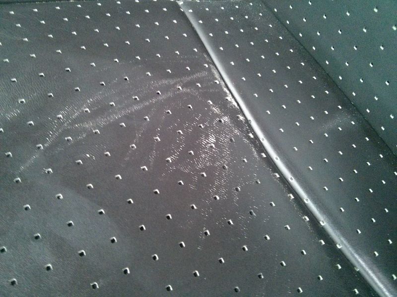

Hello Forum :)
Almost everything is in the title: I just bought a C5 with the semi-aniline leather pack (pierced leather, matt black, thick and very flattering).
Unfortunately, the conductive seat is a little scrubbed / scratched, I think by materials like jeans (or buttons and eyelets that are often placed on the buttocks). To the touch, there is no relief; only the color is gone.
Here are 2 pictures of the problem, seen from afar and then closer:
- h
ttp://hpics.li/fae5b0f - http://hpics.li/5d10cb1
Which product would you recommend to me to permanently re-colour the leather?
Thank you for your feedback and have a good Sunday:)
Raph
In your case, the application of a small layer of black pigment recolouring agent followed by a coat of matt varnish is sufficient. It will be necessary to break the original varnish by the light friction of a sopalin, moistened with acetone.
We add that it will be necessary to apply the sopalin recolorant to obtain a fine recolorization.
