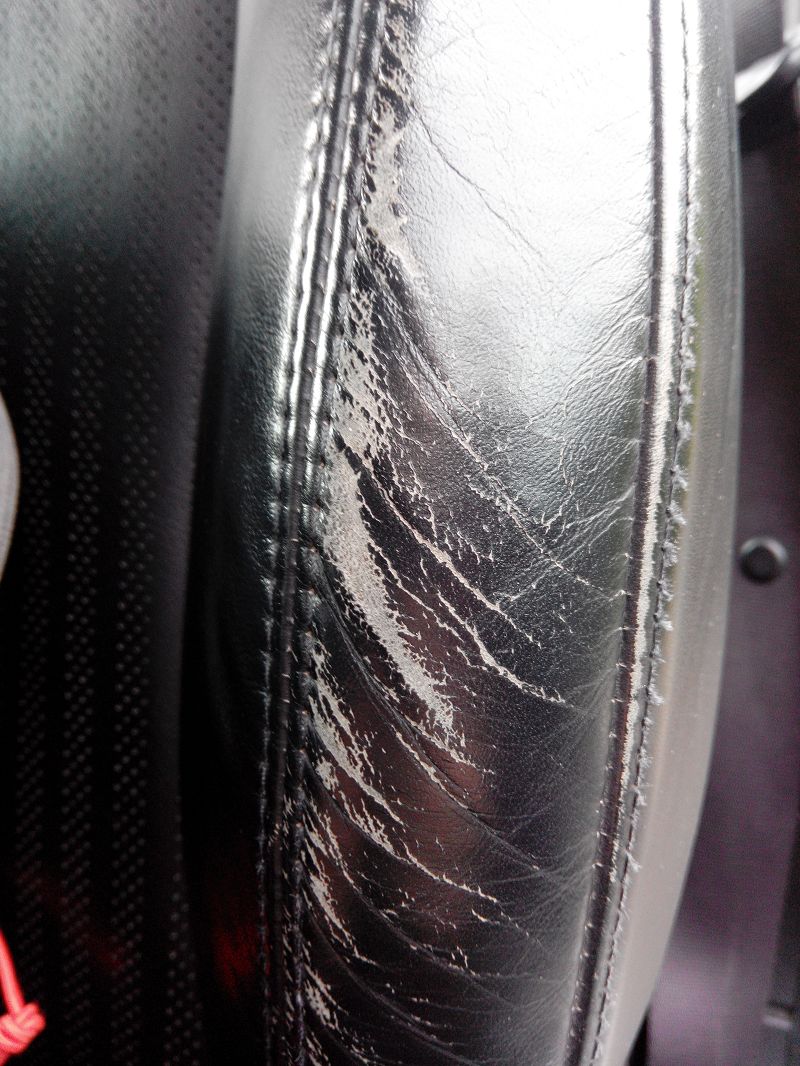

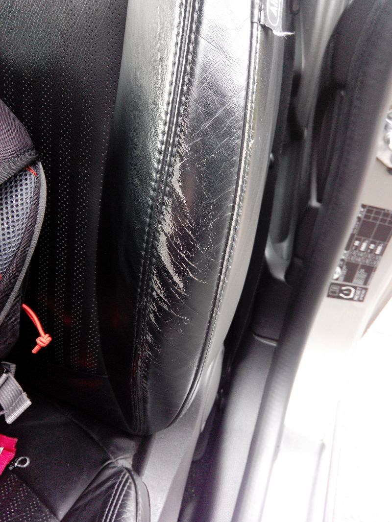

I am very interested in your product ranges. However, I hesitate as to the choice of the renovation kit.
As you can see in PJ, the seat is colorless and erafle. So I looked at these two kits, but which one would be the most suitable?

If you have.that what you have shown us, to renovate, the mini black kit is enough.

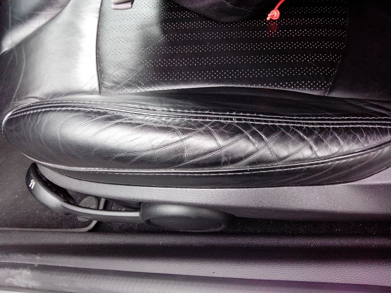

I added a photo that I had not put initially because the renovation is (I imagine) less.
For the most damaged part, it is therefore not necessary to apply paste despite the leather that has been scratched? (the surface layer is therefore gone).
Maybe you will need to put some paste on it is difficult to see on the pictures but in this kit you have the paste. We recommend that you apply a first coat of recolouring agent after a light sanding, if the difference in level between the good and damaged part is too great and you feel a hollow, tint a little paste with the black recolouring agent and fill in this difference so as to obtain a smooth surface. Don't forget to sand before applying the paste and after drying.
