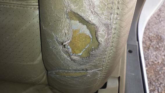

Is it possible to use a very thin piece of leatherette to put under the leather in the case of a hole before putting repair paste or should only a piece of leather or non-woven be used.

Before I start repairing my seats, I need more information.
In your instructions, nourishing oil comes into phase 5.
In my case, wouldn't it be better to put the oil first because the seats are very dry before putting the repair paste because I read that afterwards, the oil wouldn't penetrate when there was paste.
If this is the case, would the repair order be:
clean and sand
Oil to soften the leather (let dry)
Repair holes and cracks
Recolor with pigment recolorant
and protect with varnish
Thank you for your help before making mistakes.
