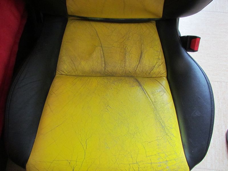

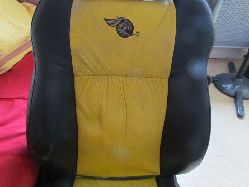

I want to renovate the seats of Civic Jordan yellow and black, the yellow is varaiment much cracked see pictures, the black not too much just a small hole and some stripes. Do you think I can, with your products make them really come back well. And for the yellow tint, isn't there a number to find specific to this model. Thank you for your answer. Sincerely.
There are no particular problems to renovate these seats except to choose the right yellow one which is not in our colour chart. You can send us as a reference to make this colour as well as a yarn reel as a piece of fabric or a coloured paper. However, we advise you to grease the leather before renovating it.
