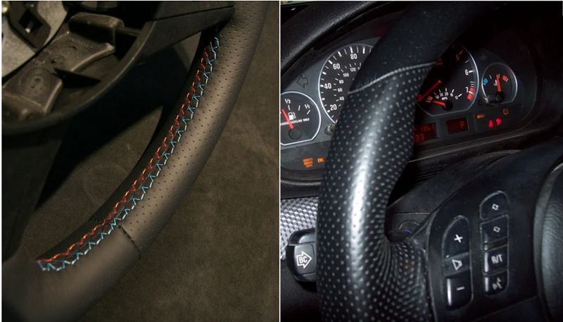

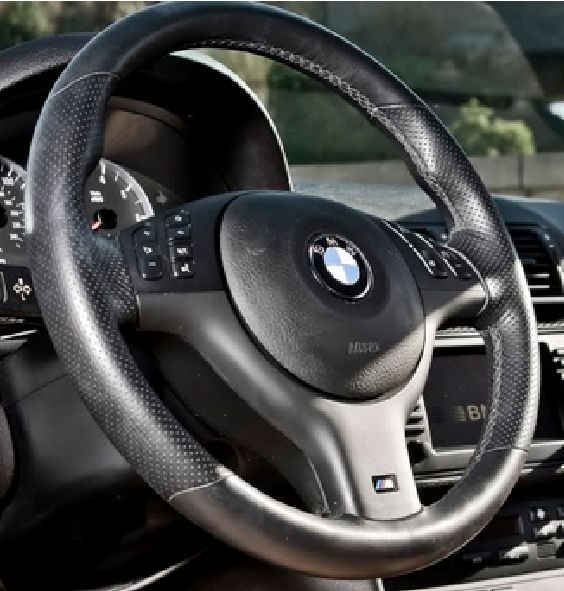

I would like to renew my steering wheel to switch to mixed full leather / perforated leather, the problem is that the box that does this only works with matt leather, what would you advise me to transform their leather into good old shiny leather?
For more clarity, once this subject is valid I will attach a photo of what I will start from and the result I am looking to achieve.

    The matt, satin or gloss finish is given at the base by the original varnish. You can change the matt finish by applying two or three coats of gloss varnish.
    Thank you for your answer, and what varnish do you recommend to me to have a similar rendering to the one of the photo? shiny or satin?
  3. Reply
    We recommend the brilliant
