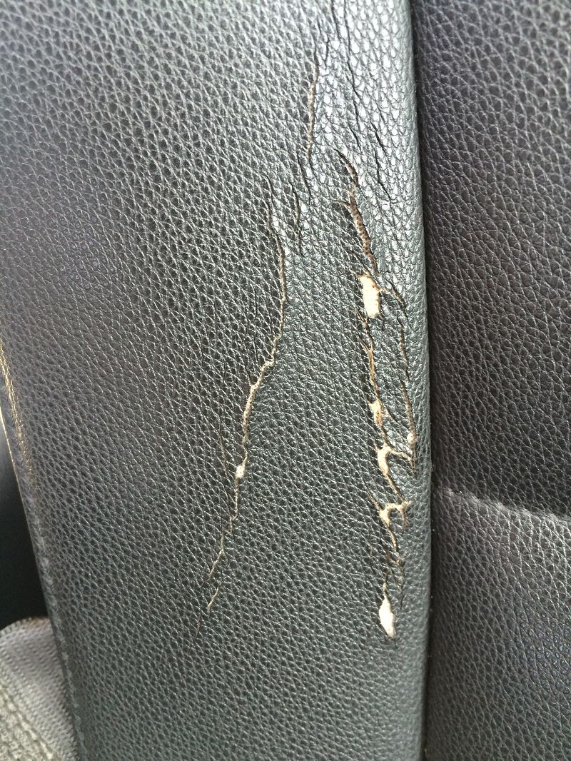

I would like to repair the seat that I will post next. Can you advise me on the renovation kit to buy? Thank you in advance.

    You have in the renovation kit leather seat driver's seat the necessary for your repair. We advise you to grease the leather well before making the repair, wait a few days for the oil to infiltrate well into the fibre mattress. You will certainly need to make a lamination because the leather seems fragile in many places. In this case it is better to open the leather, stick a piece between the foam and the flesh side of the leather, with the repair paste.
