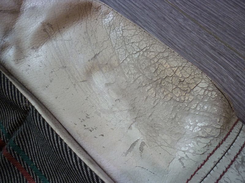

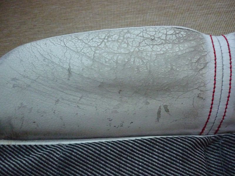

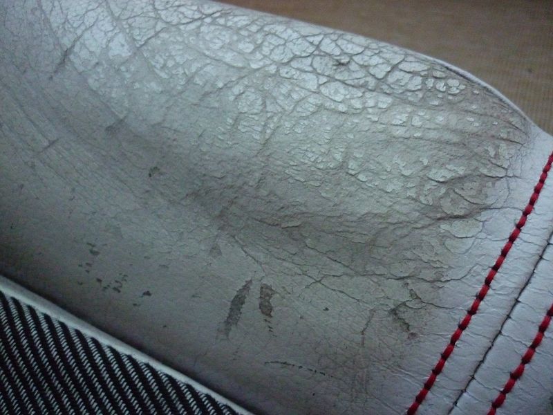

I am currently restoring the upholstery of my 205 Roland Garros.
Unfortunately, in one place, the leather is damaged over a fairly large area (11x8cm). And, I don't really know how to apprehend this area, since the flower of the leather is no longer present. I have repair paste, but I am not sure that it can be applied to such large surfaces.
Do you have a solution to treat this area?
Thank you in advance for your answer,
Sincerely.
It is not the grain of the leather apparently, but the original re-colouring agent that flakes. Sand and peel to make the leather as smooth as possible, then spread a thin layer of paste with your finger, apply a coat of recolouring agent after sanding the paste layer... Depending on the result, spread the paste or several coats of recolouring agent again.
