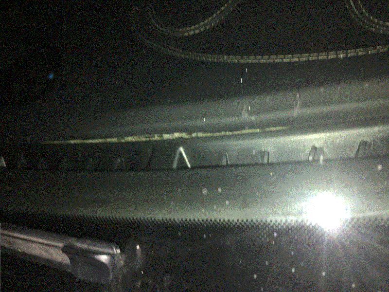

I have my dashboard that is broken at the air vents, do you have the possibility to take this back?

Hello, we have to dismantle the dashboard, then with a lot of patience using a dryer to soften the leather and a tool to loosen the leather starting on the passenger side 1st solution once reached the loosened place try to remake the seams and stick at the back a yoke to solidify 2nd solution take everything off and take it to a saddler then you will only have to put special glue saddlery but just at the edge no need to do in full if this defect of the 307 CC exists it is sewing too close to the edge too tight and to fill completely glued, except that a dashboard exposed to the sun softened the glue and there problem the glue retains the leather and the seams let go Here is the opinion of a woman

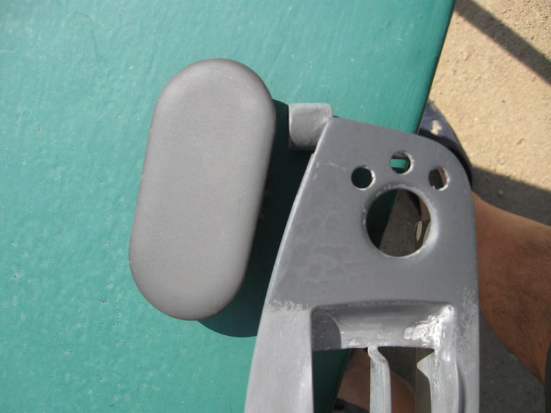

Hello marc
I sent you a black soul hood that 1 cm, I know it's small but the other trimmings are too big!
A fuse cover of the same colour as the passenger compartment, if you can make this colour it would be perfect! 100 ml is enough!
on the other hand, the water-based paint is shiny you have matt? or satin for the passenger compartment?
I also sent you the same cache because the color is almost identical but it is a special grey the swing is between grey - brown - green!
see picture we're not far away but it's not that
for leather the color is good friends too bright the leather is smooth is matt with a green or brown we are almost perfect at something ready.
I know it's hard to find the right color, but the best bodybuilders can't make 10 to 15 colors with the reference to find the perfect color!

We can't see very well on the picture, the first question is: what is the material, leather or leatherette? Is the tear through, i.e. the plastic is it visible?

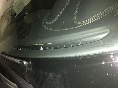

I have the same problem on my Brera, which is only 31,000 km long.
