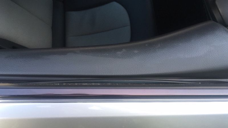

I own a car whose upper part of the Skai door panels no longer seem to have a varnish layer in some places (sun or bad maintenance product...)
Could you tell me if you have a product that can solve this problem?
Attached is a photo of the party concerned.
by thanking you.
  • Renovation of tarnished door panels
    It is difficult to know if it has been attacked... We recommend that you obtain 125ml of colourless leatherette varnish and test the rendering on a small damaged and undamaged area to see if the final rendering is identical. If this is not the case, you will have to repaint your leatherette with our imitation leather / leatherette paint.
