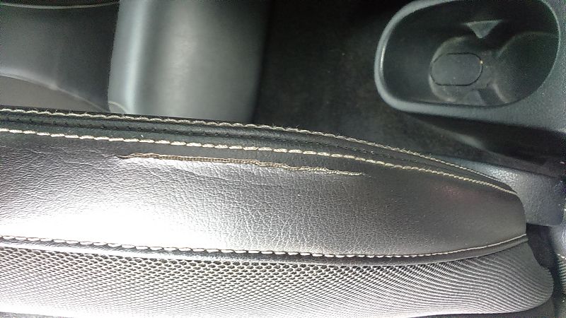

Hello, I have just discovered your products, what do you propose me for the repair of cracking of the leatherette of my car seat?
There is a solution: apply cyano glue to both raised edges and then place the liquid version of the snag repair in the fault, let it dry and then re-colour.
Thank you. Thank you.

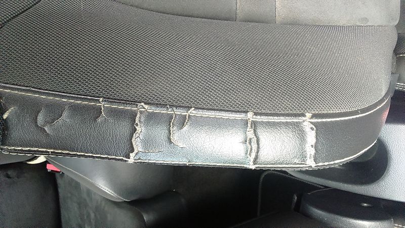

On the other seat the leatherette is much more damaged, can I use the same product?
Yes, but do the work on a horizontal surface.
