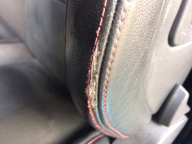

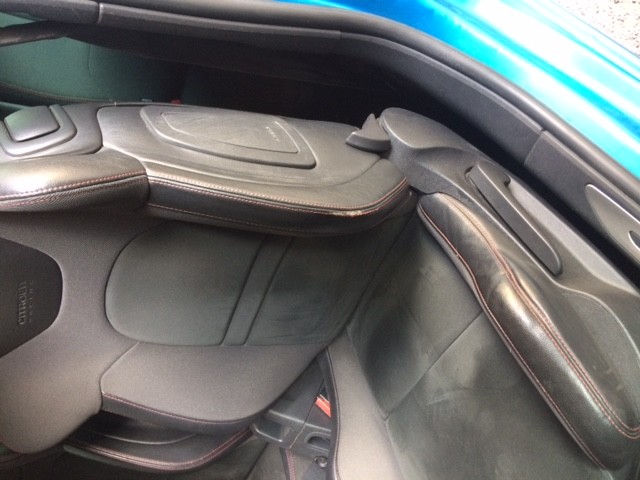

Good evening,
I would like your advice, and your help....
I just bought a vehicle, and the wear and tear on my leather seats came quickly.
Could you help me?
DS3 Racing seats (Normally) mounted on a vehicle from Germany that had to be tampered with, because I had problems with injectors too, and couldn't communicate with the ECU... Anyway, I got screwed... Anyway, I want to take care of it... I'm counting on you...
Have a good evening,
Sincerely, Pierre.

    The repair of the outer bead of your driver's seat can be carried out with the help of our leatherette repairer.
    Once the repair is done, it is necessary to recolour it from above to hide it.
    Our skaï paint is available as standard in many colours. We also have some leather colours at Citroën here.
    The choice of the surface to be recoloured depends of course on your desire. We recommend painting the entire seat for an optimal and homogeneous result.
    Once the paint has been applied and dried, it should be protected with a suitable varnish (satin, matt or gloss).
    Aware that it is not always easy to choose the right products and the right quantities of products, we provide complete restoration kits for leather / imitation leather, which simply vary according to the surface to be renovated.
