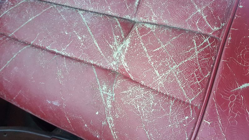

I would like to be advised on the products to buy in order to repair the upholstery of my 1976 Cadillac.
As soon as my subject is valid, I will post pictures in order and I would like that:
- you were advising me on the color reference to choose
- you told me which products and in which order I should apply them
Thank you very much in advance!
Christophe

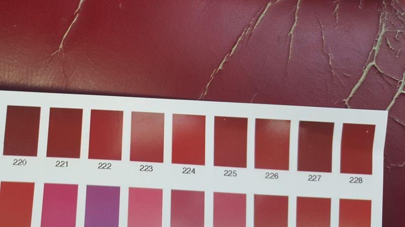

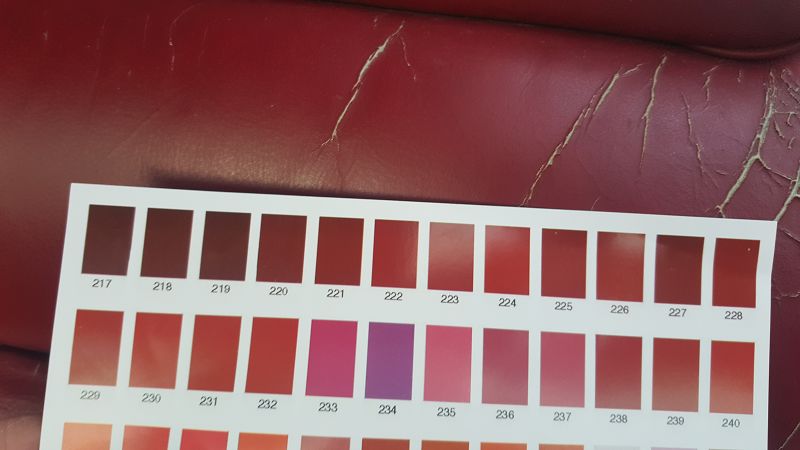

Before renovating your seats we advise you to grease them well with the "foot of beef oil" after the cleaning phase, let this oil infiltrate for about eight days before re-colouring. sand before applying the first coat, if the surface is not smooth fill the cavities with the repair paste. We recommend the conductive kit or the renovation kit for front and rear seats and rear bench according to the recolouring you have planned. We will replace the edible oil by the oil "pied de boeuf", please let us know in the comments of your order. for the color it is difficult for us to advise you in view of the pictures, you can perhaps take a slice of leather under a seat.
Thank you very much, it means that I can send you the sample so that you can give me the right color reference?
When you say sand, what type of sanding do you recommend?
Thank you again
Send the sample to Sofolk Darnat 24490- LA ROCHE CHALAIS
For sanding, the fine sandpaper is delivered with the kit.
Just to confirm that my garage owner Philippe GUY has sent you a sample of the upholstery.
Thank you in advance for telling me when you will have received it and the products you will recommend at that time.
Yours sincerely
Christophe
