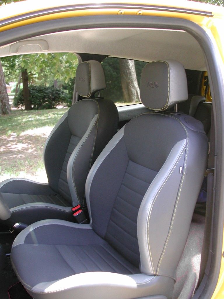

I would like to re-colour the white leatherette parts of my vehicle's upholstery in grey.
So I don't have a reference grey. I would just like it to fit in with the rest of the upholstery (while remaining a little clearer).

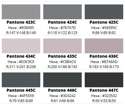

In the 432 colour chart I ordered from you, I have trouble finding a shade of grey that seems quite neutral to me.
All seem to be quite far from the grey scale (whether towards blue, green or red).
Would you have the RGB codes of these 432 colours or any matches with the Pantone colour chart or even the grey colour chart you use for plastic recolouring, please?
This could help me determine the appropriate grey intensity.
(I imagine it is between R:90 V:90 V:90 B:90 and R:50 V:50 B:50)

    Indeed, the grey of the colour chart does not correspond to the RGB 90 or 50. We can make your grey by taking as reference any material even a reference of a grey on paper, if you can't send us this reference, give us the pantone reference.

    I have seen that for the re-colouring of interior plastics you have selected shades of grey ranging from 108/105/112 to 54/51/56.
    Which already gives me an indication.
    I intend to opt for the most neutral grey possible (R=V=B).
    All I have to do is determine its intensity, which would be close to that of your colours 425 to 428.
    If you have their RGB equivalents, I'm a taker.

    I have noticed the following color:
    Pantone 425C
    Hexa: #56595C R:86 V:89 B:92
    Is it part of the Pantone (C) range you use, please?

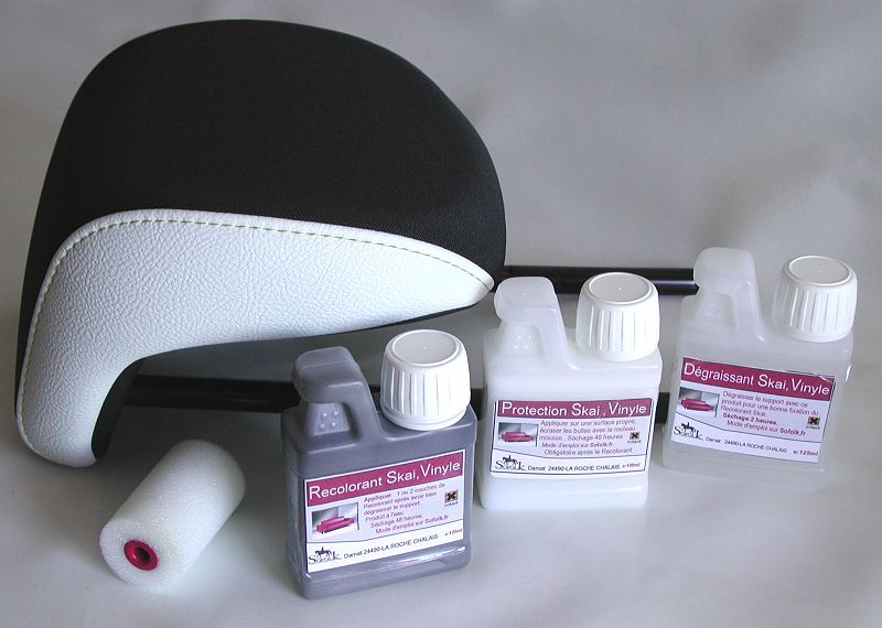

    I just ordered you a "SKAI RECOLORATION KIT All colours 1 armchair" in Pantone 445 colour.
    Hexagonal grey: #565959 R:86 V:89 B:89 which should be suitable.
    I have specified'less wide foam' (concerning the roll provided), as you suggested (the seat strips are 5cm wide).
    I will keep you informed of the result.
    Sincerely,
    Emmanuel.

    I received the leatherette re-colouring kit.
    I'll start with the rear headrests, which are less conspicuous, at the end of the test.
    To be continued... ;-)

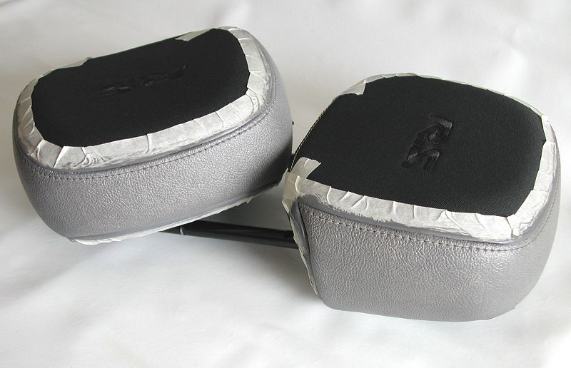

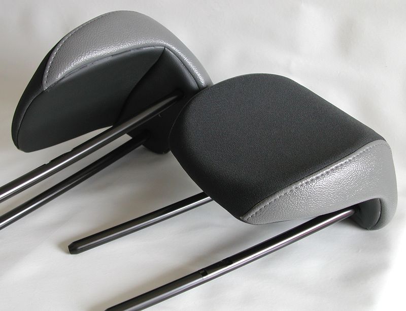

    I took advantage of the slightly more moderate temperatures and finally dry weather to get to work.
    And so I got my hands on the back headrests.
    I have no particular concern, except with the masking that remains delicate between 2 shades that could not be more contrasting (black and white).
    The grey re-colorant had a little trouble covering the white.
    Contrary to what is indicated in the "Advice on re-colouring leatherette and vinyl" I did not find it very concentrated (even after conscientiously shaking the bottle).
    On the contrary, I had to apply it with a brush and give up the foam roller, which did not deposit enough pigments.
    It must be said that this leatherette is very granular.
    I was satisfied with 2 layers, even if in some places a third layer would not have been too much.
    On the other hand, the roller has proved very useful for the application of protection, which tends to foam.
    I accelerated the drying of the different coats with a thermal stripper (without hair dryer) set at minimum temperature, blower at the highest temperature and held 20cm from the leatherette (between 60 and 70ÂC).
    The process seemed to me to be quite effective. This is probably due to the low thickness of the layers and the water-based nature of the products, which evaporates easily.
    The colour, very silvery in the first layer (with the white support in transparency), corresponds to the final result I expected.

    I'll continue on the front headrests.
    First coat of re-colouring agent during drying.

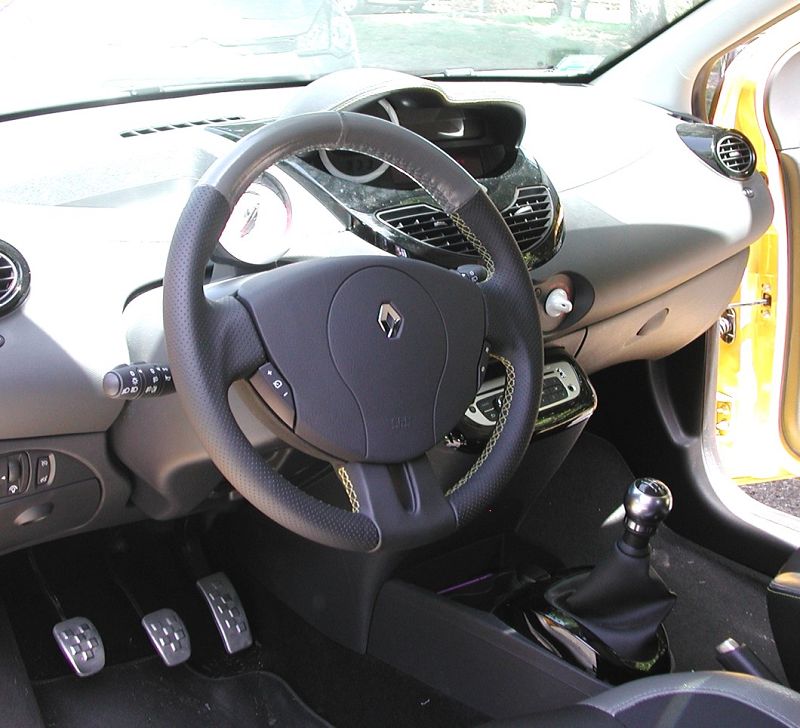

    The dimensions of the front seats as well as the top of the steering wheel.
    Parts that cannot be dismantled (easily), to be treated directly in the passenger compartment (reduced access and lighting), within certain time limits (I could not stop the vehicle for more than 2-3 days) and which will then be subjected to friction (to be well protected).

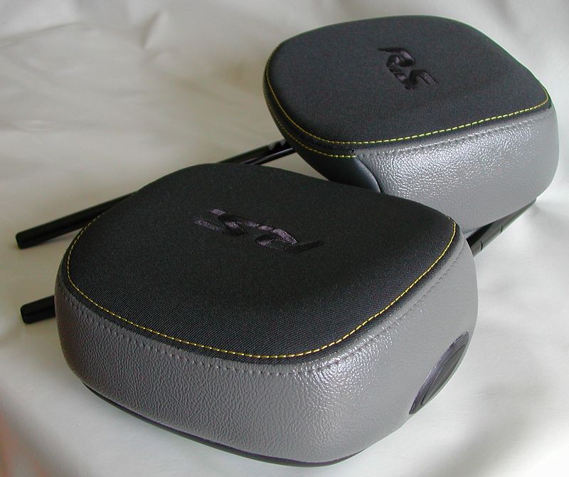

    Headrests before finishing.
    Let be 1 layer of preparation 3 layers of grey 1 layer of protection.
    I applied each product with a brush before applying it with a roller.
    They are all very easy to apply and you can even easily distinguish between the parts already covered and those still to be done (the colour, for example, darkens when drying).
    The tools are very easy to clean (with water) and the overflow of recolouring agents on the surrounding plastics leave with alcohol (once dry).
    I didn't see any stains on the fabric (so it doesn't seem to stick to it).
    The grain of the leatherette remains visible.
    The finish may be slightly too bright for my taste (it was originally matt).
    I'm getting to the biggest piece as soon as possible... ;-)

    The re-colouring of the upholstery (seats and steering wheel) is now complete and I am generally satisfied with the result.
    The shade, chosen a little blindly, suits me very well.
    The products are really easy to apply. They do not stick, spread well and are easy to clean. Even d
