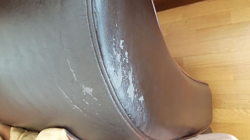

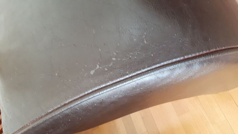

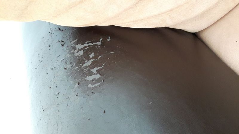

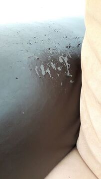

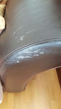

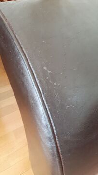

We have a 3-seater black leatherette armchair purchased from Maison Coloniale 10 years ago.
Today, the skin is getting more and more removed and I don't know what to do.
Could you advise me?
Thank you in advance,
  • Repair armchair imitation leather Colonial House - 1
  • Repair armchair imitation leather Colonial House - 2
  • Repair armchair imitation leather Colonial House - 3
    In your case, it is the colouring that comes off and we can provide you with the products you need to renovate your leatherette sofa.
    Since your problem is all over your leatherette, you will have no choice but to recolour your entire sofa to get an impeccable result.
    To do this, you will need the following products:
    - acetone (which you can find at a lower cost in most specialised shops or supermarkets
    )- 500ml
    of
    black skaï paint
    - 200ml of satin clear skaï varnish - accessories (optional): a 240 grain abrasive paper sheet (or 400, a foam roller)
    The renovation of leatherette is very easy and within everyone's reach. A complete manual will be delivered with your products.
