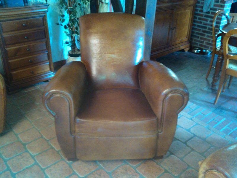

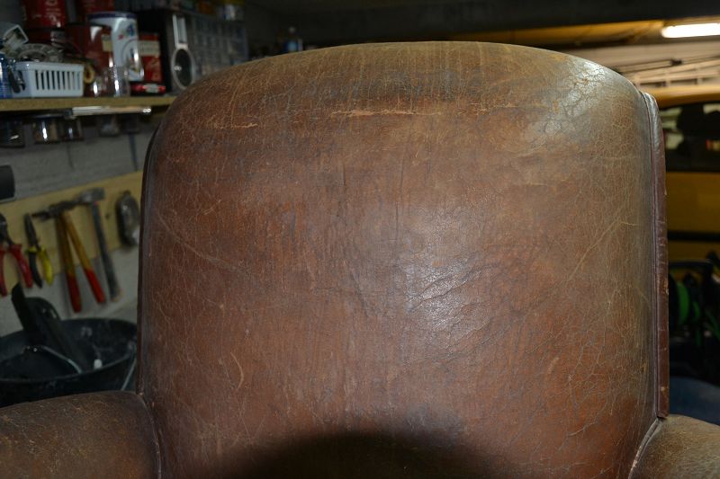

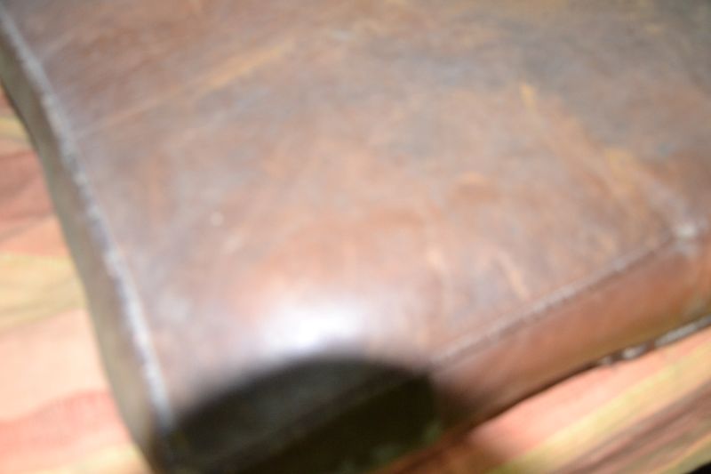

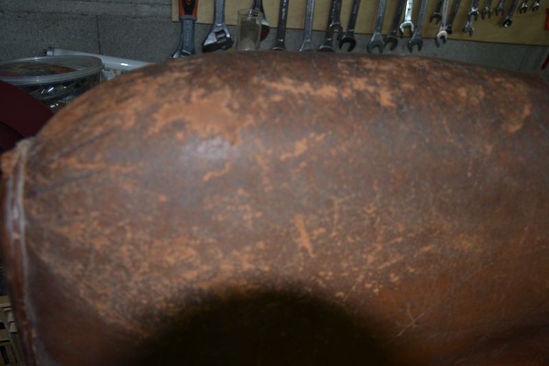

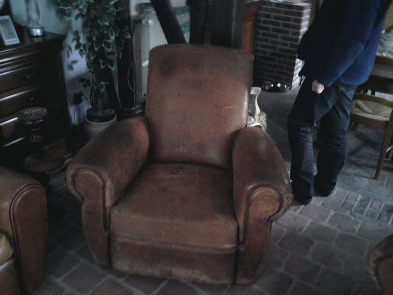

hello I repaired my club chair which was well damaged sitting changed in half the two armrests were partly well attacked pieces of leather more paste of repair and pigmentary recoloring then tawny dyeing and to finish the wax in spray the work was done by me even following the advice of the technician.

    Very nice work of restoration of club chair! Thanks again for your photos.
    I have a club chair in the same condition as yours before restoration, you apparently did well this restaurant.
    By what steps and products have you used?
    I was thinking of applying a resin and a mastic to restore the scratches and alterations of the leather and then applying a recolouring balm and a fixative.
    Is this the right approach.

    1- clean with universal
    cleaner/remover 2- apply the leather repair paste in cracks / cracks / scratches. If there is a tear, make a lamination with a small piece of leather that can be supplied free of charge with your order. The lamination is also done with the paste which allows the leather to be soldered/adhesive.
    3- apply the pigment recolouring agent which will give a uniform colour. Our pigment re-colouring agent does not require a fixer and is simply applied with a foam roller!
    4- if you want to have slight shades of color (always in the same shade), order an aerosol of dye or directly of tinted wax that will allow you to do this rendering.
    5- if you have opted for the dye spray, you will have to apply the wax, in order to create the famous "patina" that makes the chairs so beautiful.
