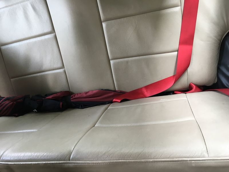

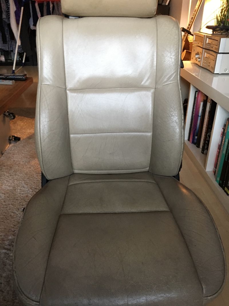

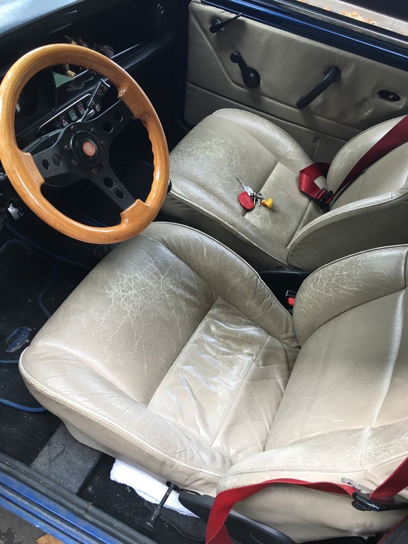

    Hello, I would like to change the color of my seats and roof sky to black.
    It's an Old Austin Mini
    They're a little cracked but soft, I think it's real leather because of the thickness.
    Is it possible to change the color and if so, what would be the steps and cost?
    Thank you to you
    There is absolutely no problem to recolour all your leather car seats in black. For this, we have a kit that perfectly meets your expectations here https://www.renovation-du-cuir.fr/en-gb/car/leather-seat/complete-kits_18.html. The instructions for use and the order of application of the products will be sent to you at the same time as your order.
    Concerning your roof canopy, it is certainly not made of leather, the products in the kit proposed will not be suitable. On the other hand, we can perfectly provide you with black aerosol dye. Count 1 to 2 aerosols according to the color to be covered (29.90âA / aerosol).

    By default, the kit is finished in satin (between matt and gloss). The glossy finish is applied a lot on leatherette / imitation leather and more rarely on leather. However, we can easily provide a glossy varnish if that is your wish. From the picture, I'd say it's a shiny finish. If this is what you want, indicate the finish in the comments when you place your order.
    Concerning the duration of the renovation, you can accelerate the drying with a cuttlefish hair (cold position) and thus pass your 1st coat of varnish. Do not forget to apply 2 more layers of space after 1 month.
    Many car refinishers do the job during the day using the hair dryer and give the customer varnish that he will have to apply himself later as indicated above. So you should be able to use your vehicle very quickly.
    For oil, you do not necessarily have to pass it before renovation, unless your leather is really dry (which is obviously not your case). Over the next few months, apply 2 or 3 coats to nourish it and restore its suppleness.
    If you do your renovation correctly and apply the cleaning products as indicated, we guarantee a minimum of 5 years of wear in heavy use.
    The kit you mention is perfectly adapted for your case. However, you will need to obtain acetone to break the original varnish and allow the dye to descend into the fibres. To do this, simply lightly sand your leather with the sandpaper provided in the leather, then strip without too much pressure with acetone before colouring.
    We also recommend a double cleaning with the universal cleaner/remover, which is really a great product to remove any traces of sebum (among other things).
    Finally, to answer your last question, if the first layer of dye you apply does not adhere well despite drying, it means that your leather has been badly cleaned, that its fibres are saturated, and that the dye does not go down and remains on the surface. It is then necessary to start cleaning again in a more thorough way.
    Hoping to have answered all your questions....
