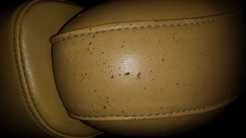

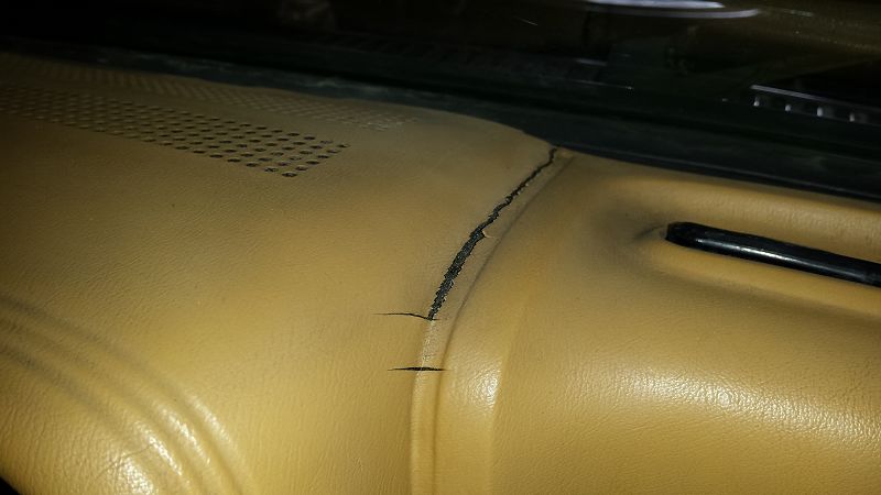

Could you tell me if it is possible to repair holes on a leather car seat and a crack on a dashboard.
Concerning the holes in the leatherette, it is actually the layer of leatherette that is missing because there is always fabric underneath.

    For the holes no problem, the paste repairs snags and recoloration. For the crack you will have to slip a piece of leatherette or leather, glue it with Neoprene and fill the crack with the same paste and recolour.
