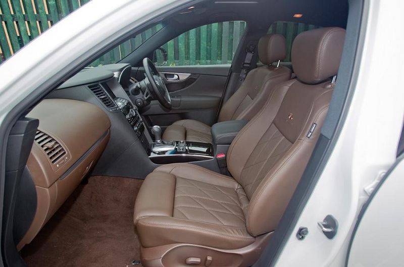

I own a 2011 Infiniti, the leather front seats are dark brown, I would like to know if it is possible to change the shade to a matte black?
In the same way I would like to repaint some of the plastic elements.
Which products do you recommend?

    It is quite possible and easy to renovate your leather car seats in another darker colour, such as black at the moment. The black color is very covering, you will probably have to apply 3 coats instead of 2, but this is not certain.
    Here are the products you will need for your colour change, assuming that you will not need to make any repairs:
    - 500ml of black leather paint -
    125ml of silky matt leather varnish (it is the varnish that gives the finish)
    - 125ml of nourishing leather oil
    For information, a complete user manual for leather renovation is provided with the products as soon as the pigment recolouring agent (paint) is ordered.
    For the plastic elements to be repainted in black, you will find our black plastic paint here
