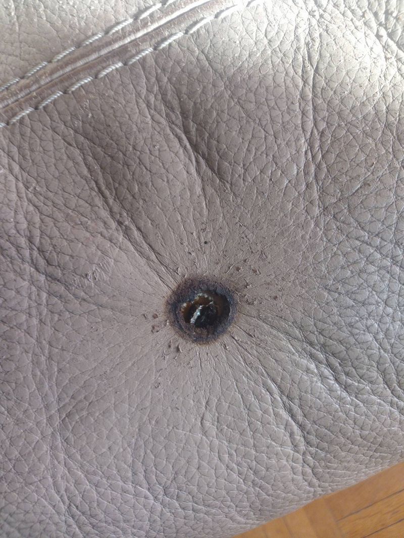

I would like to repair a burn the size of a 2 cent coin on my leather sofa. What do you advise me for this?
I'll send you the picture.

    You need paste and re-colorant. You will have to sand and then apply the repair paste, several coats will be necessary to fill the cavity, deposit in thin layers, sand each time and then recolour and varnish. to have the right colour you will have to send us a leather slice (3 cm long, 5 mm wide minimum).
