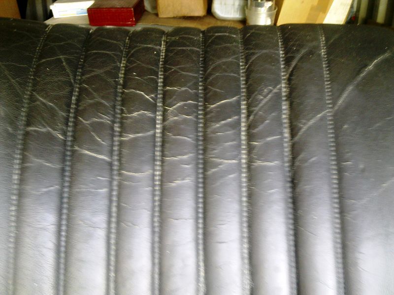

Which product to fill DS' (unopened) cracks
Thank you for your answers
  • Siège DS
    in your case, you will need our black leather repairer (paste). This product will fill your cracks and large cracks that have not penetrated the leather. If the leather has been passed through, you will first need to laminate a piece of leather between the foam and your leather before applying the paste.
    Then, even if the paste is black, your repair will not be invisible. You will then have to recolour your seat (all the seat), in order to obtain a perfectly homogeneous and satisfactory result! Link to our black leather pigment re-colouring agent

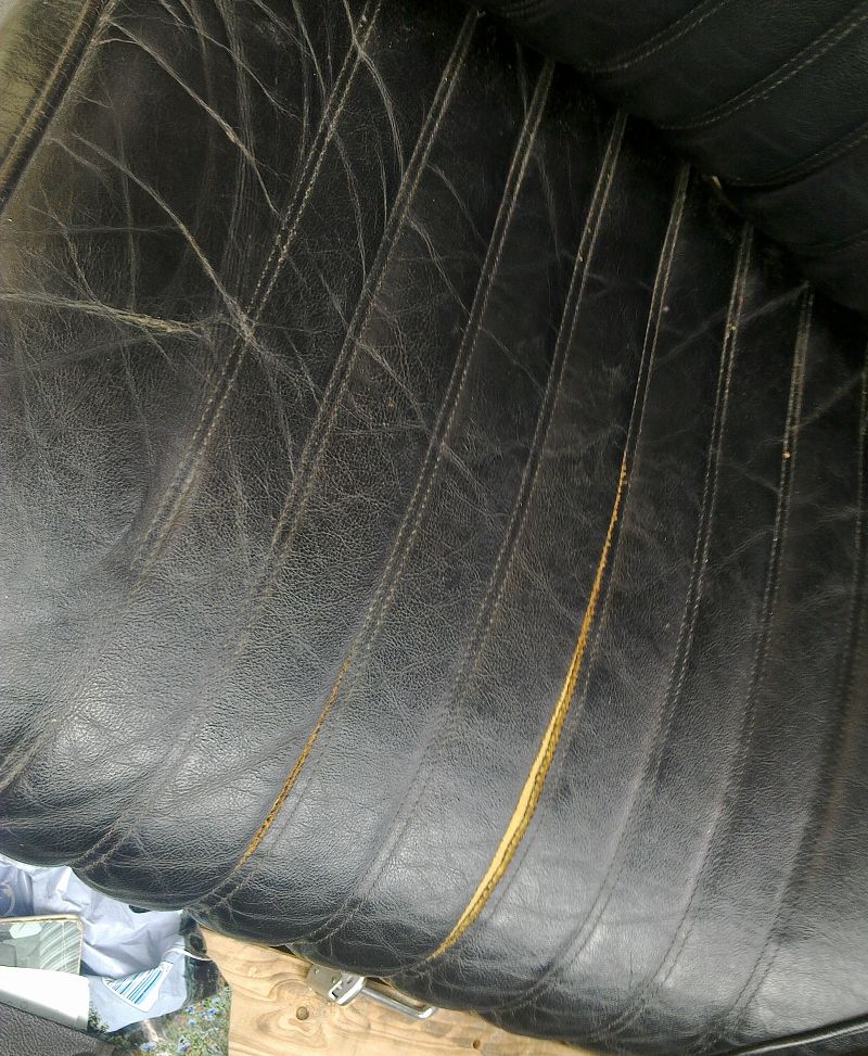

    Thanks for the answer, I have another torn seat, a solution?
