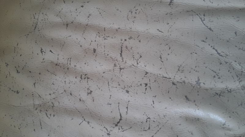

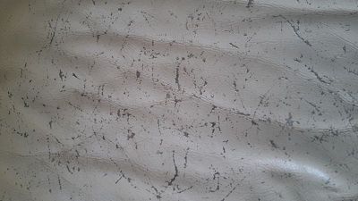

I would like to order the Leather Renovation Kit 2/3 all colours for a 3-seater beige sofa that has been damaged by our cats (see pictures in PJ).
Could you recommend the colour to choose and the best method to repair the scratches on the leather?
Thank you in advance,
  • Repair of sofa
    Hello and thank you for your interest in our products.
    Repair is very easy with the leather repellent paste. Before staining, simply fill in the cracks with a spatula. Let dry and then sand to remove the excess.
    Concerning the color, when you order your kit, indicate in the drop-down menu "color", the color, which has the screen and according to you corresponds approximately to your desire. We will be able to send you a colour chart of about thirty shades around your selection.
    Note that from your photo, your leather seems slightly dry. We recommend that you apply nourishing oil after your renovation.
    The first application should be made 1 month after staining to allow time for the dye to descend into the leather. Wait 15 days apart for the 2nd coat and at least 15 days apart for the last application.
    The oil is applied with a washcloth. Soak the glove lightly and massage the leather gently.
