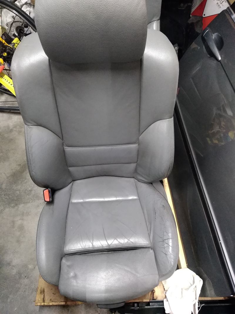

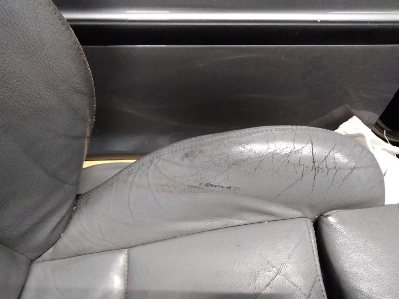

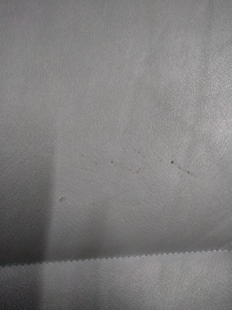

Hello.
I will certainly buy a 5 seat for BMW 5 doors e46, it is a grey M pack.
The leather is cracked on the driver's bead and the rear seat has a scratch. I wanted to know if it was repairable.
Also how to catch up this kind of sinking into the leather, certainly due to storage?
Thank you for your help.

    Hello, your grey BMW leather car seat is perfectly repairable.
    Scratches and cracks can be repaired with the repair paste. It will then be necessary to recolour.
    As far as the front seat recesses are concerned, the only solution is to add a little foam underneath....
    Here is the link to our leather car seat restoration kits. It is up to you to choose the one you want, knowing that they all have the same products, but in different quantities depending on the area to be renovated (number of seats).
    Concerning the renovation method, here is the link to our tutorial for renovating a leather car seat.
    With this information, you are in principle perfectly equipped to do a nice job!

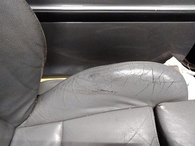

    I also have a bmw e46 pack M with leather seats exactly as shown in the picture.
    mine are less damaged than the picture but show some spots and I think a painting could do the trick
    do you have this product available?
    Sincerely.
  5. Reply
    It is not possible to determine with certainty a color from a photo. At BMW there are many grays...
    If you know the name of your color, order the recolorant and choose the one that matches from the manufacturer's color chart.
    If you do not know the name of the color, it is nevertheless possible to send us a small sample so that we can reproduce it. Here is the procedure for sending us a sample.
