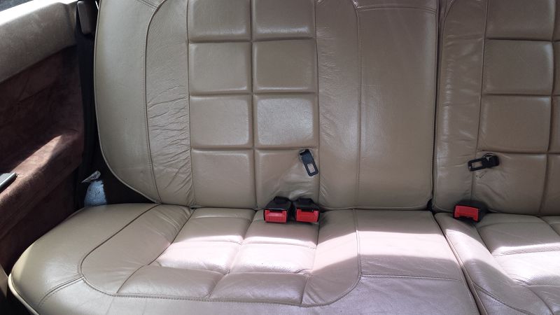

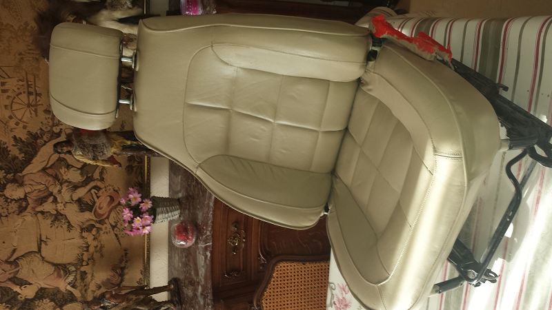

Good evening, in April I started the renovation of a Super 5 Baccara leather, I ordered the necessary products (Order No.: BDC201504/4316) and I was very satisfied with the result:
|IMG][/IMG]

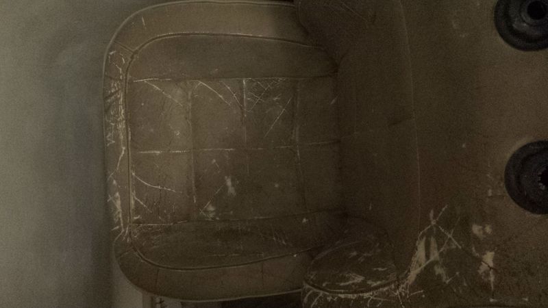

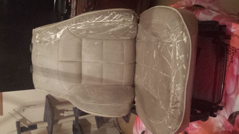

However, the color being very dirty, I had to clean the front seats several times and I think that my leather cleaner product must have attacked the silky varnish or leather paint because the seats have become extremely sticky as if I had covered them with glue, they retain everything and stick to the clothes.

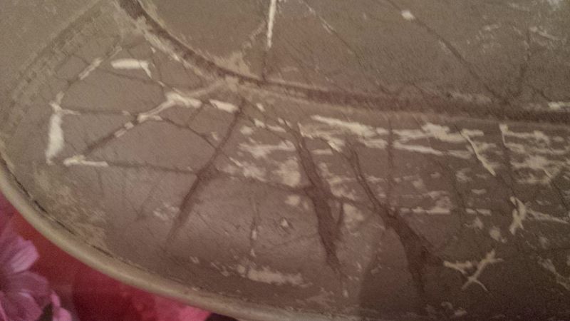

So I ordered again a black leather dye (Order NÂ: 7VX610939347416472B) and I would like to know with what I can clean the seats afterwards, moreover on one of the seats there are rather deep scratches with missing material and I would like to know if the leather paste will be sufficient knowing that the leather is not cracked or dechire, here is a picture after removing the paint and tearing the seat:
And also despite more than a week of applying foot oil, the seat in the middle remains quite hard, how could I fix it? Thank you in advance, cordially.
  • Leather renovation Super 5 Baccara - 1
  • Leather renovation Super 5 Baccara - 2
  • Leather renovation Super 5 Baccara - 3
  • Leather renovation Super 5 Baccara - 4

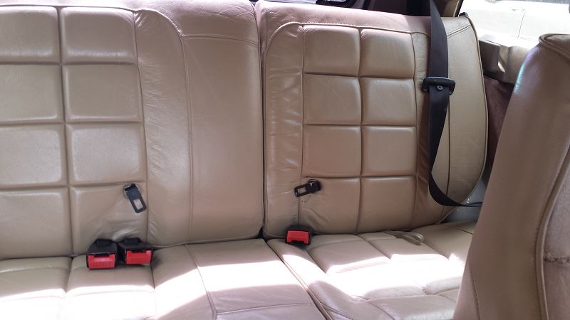

    The first picture is the result after the April renovation with which I was very satisfied, then the others are the one of the headquarters at the current time after the stripping, thank you.

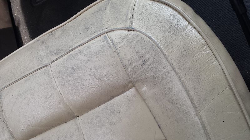

    Here is a picture of the other front seat that had been renovated and I haven't ripped it off yet, so it's sticky, yet the back seat is as you can see it still nicely.

    The explanations you give us are not very precise, please confirm what you expect from us. The recolouring must be followed by a good application of varnish to avoid rapid fouling, it is also advisable not to use any cleaner other than water-based ones.
  4. Reply
    Good evening, ok so will the repair paste be enough to fill the big grooves at the front of the seat? Apart from the following since the leather will be dyed, would it still be possible to feed it with foot oil from oxen?
    Otherwise yes, I still have some leather varnish from my previous order, cordially.
  5. Reply
    For cracks the paste will be sufficient, when it is recoloured the leather allows the oil to penetrate the foot of beef but not in the areas covered with paste.
