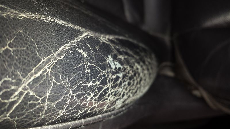

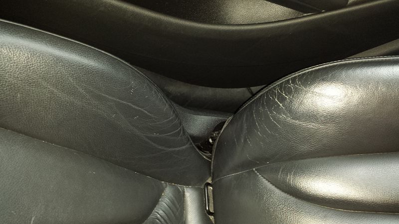

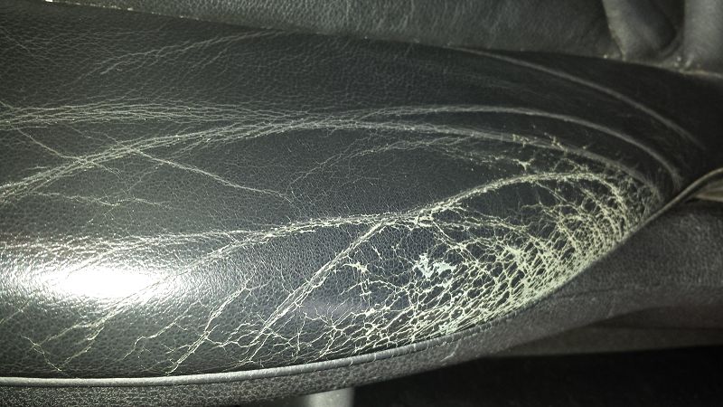

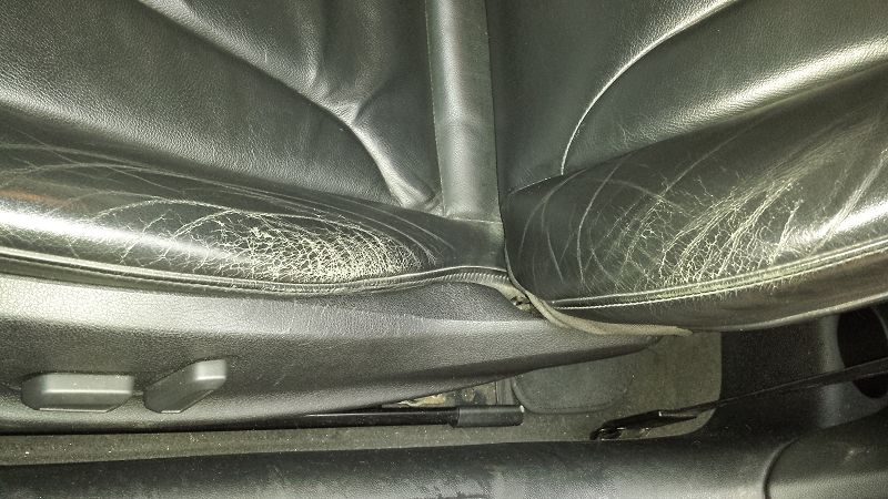

Hello to you,
As the proud owner of an Audi A5 V6 Quattro in an almost new body condition, I would like to renovate the only thing that denotes a little: my seats!
These are not very damaged but I want to have seats like new.
Could you advise me which product to buy for these small jobs?
Thank you in advance!
    Here are some pictures:
    • Leather renovation Audi A5 - 1
    • Leather renovation Audi A5 - 2
    • Leather renovation Audi A5 - 3
    We recommend the renovation kit conductive seat renovation. You may not need the paste but in the picture we can't judge the depth of the crevasses. You should first sand and then apply a coat of recolouring agent and if the leather is smooth do not apply paste otherwise spread a coat of paste after lightly tinting it by incorporating a little recolouring agent, sand and apply the second coat. You will be forced to do all the siege.

    Here is a closer look at a picture
  4. Reply
    Yes, we had seen it well but it seems superficial and anyway, in the kit we advised you, you have what it takes to repair this place, the most damaged.
