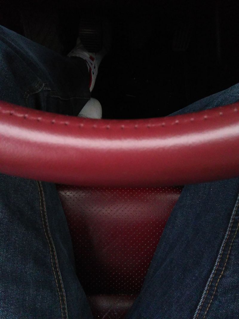

You say that the color is consistent yet that's not my opinion, nor the opinion of those who have seen my steering wheel and my speed breath. It's clearly pulling too much on the pink/salmon. The dye drips on the canister are the right color, but once applied to the leather it becomes too light.
If you send me exactly the same shade as the one you already sent me, it doesn't matter! That won't fix my problem!

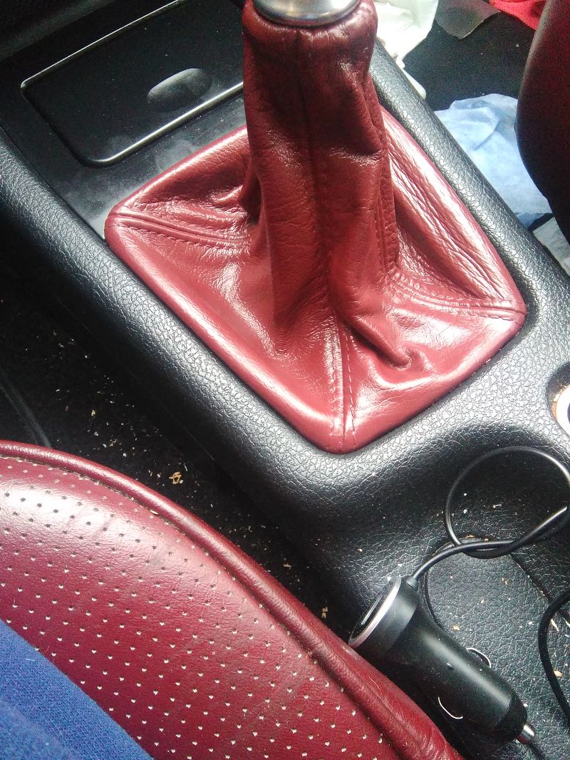

On pictures taken from a smartphone, the difference is much smaller, but you can still see that the hue is not quite the same. Between the steering wheel and the seat, and between the breath and the seat. The seat is more burgundy.

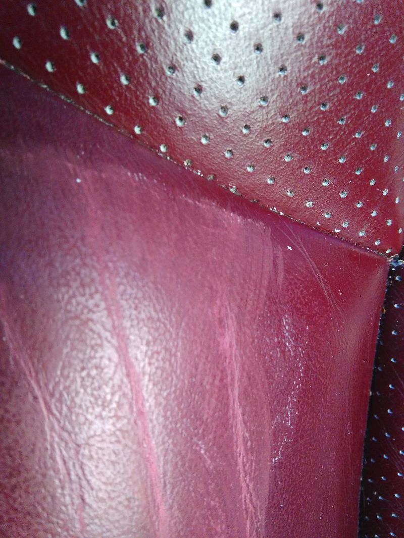

Here is another picture a little more telling.
