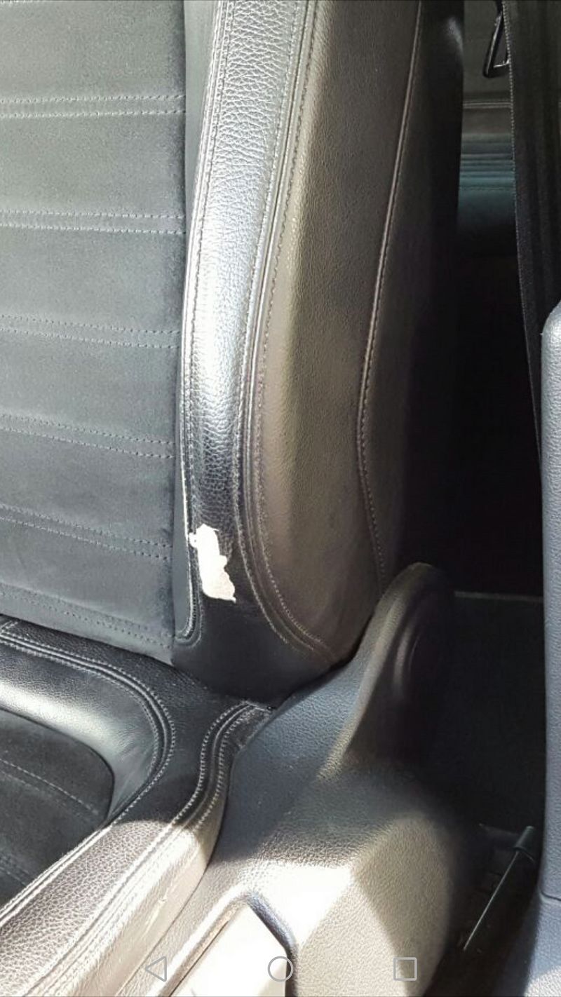

Hello. I have a hole the size of a €1 coin on the side of the seat. How can I repair it?

    I have 2 slots on the conductive seat of my black leather duster how do I proceed?
    It is necessary to slide a piece of leather and stick it with the repair paste then level the surface by depositing several layers of paste, you have the possibility to remake the grain of the leather by using the impression paste. In a few days we will present a complete repair kit including: repair paste, impression paste, spatula, sandpaper and leather piece.
