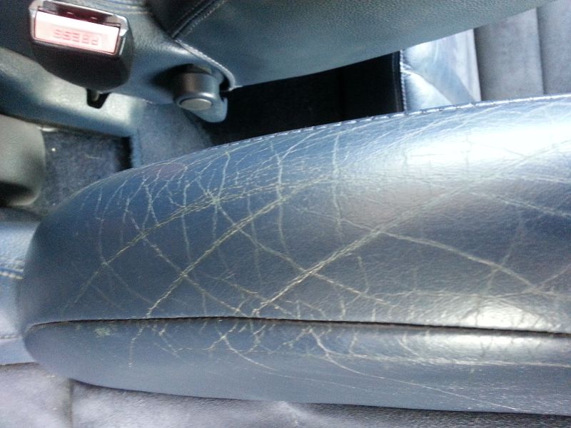

Do you know the colour for the blue leather of the clio 2 rs phase 1 seats (year 2000)?

    To be precise on the colour it would be better to send us a small piece of leather taken with a cutter under the seat. We probably already made this blue.
    We can also send you a colour chart for your choice of colour.

    You will first have to sand the leather to make it smooth (sandpaper provided) then clean the dust with degreaser, apply the paste to the cracked areas and then recolour and varnish.

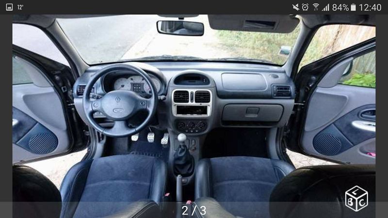

    Hello you have the answer for the color of the clio 2 rs1, I received the color chart but really not sure my choice and if I can avoid cutting a piece of leather.
    It is an rs1 also from November 2000 and there was only one leather shade for this model.
